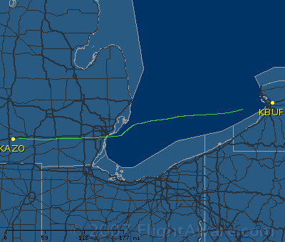

File an IFR flight plan, you will cross Canadian airpspace, but you will be talking to US controllers. Erie and Cleveland, I think.
You can see from my flight track, that's what I did.
I was going from BUF to AZO.

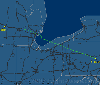

No problem, do it all the time. Just file instruments and fly just like you were in the US and A. Here is my flight plan from State College to Riverview. Larry had to show his so he's mine
