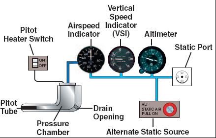

You clearly have a flow restriction in your regular static system that is relieved when you go to the alternate static system.
Pitot static is one of the simplest systems on an aircraft.

If the normal static port has a restriction somewhere in the system, it will reduce airflow. This will cause a lower indicated airspeed, and a lower indicated altitude. VSI would show a lower rate of climb/decent.

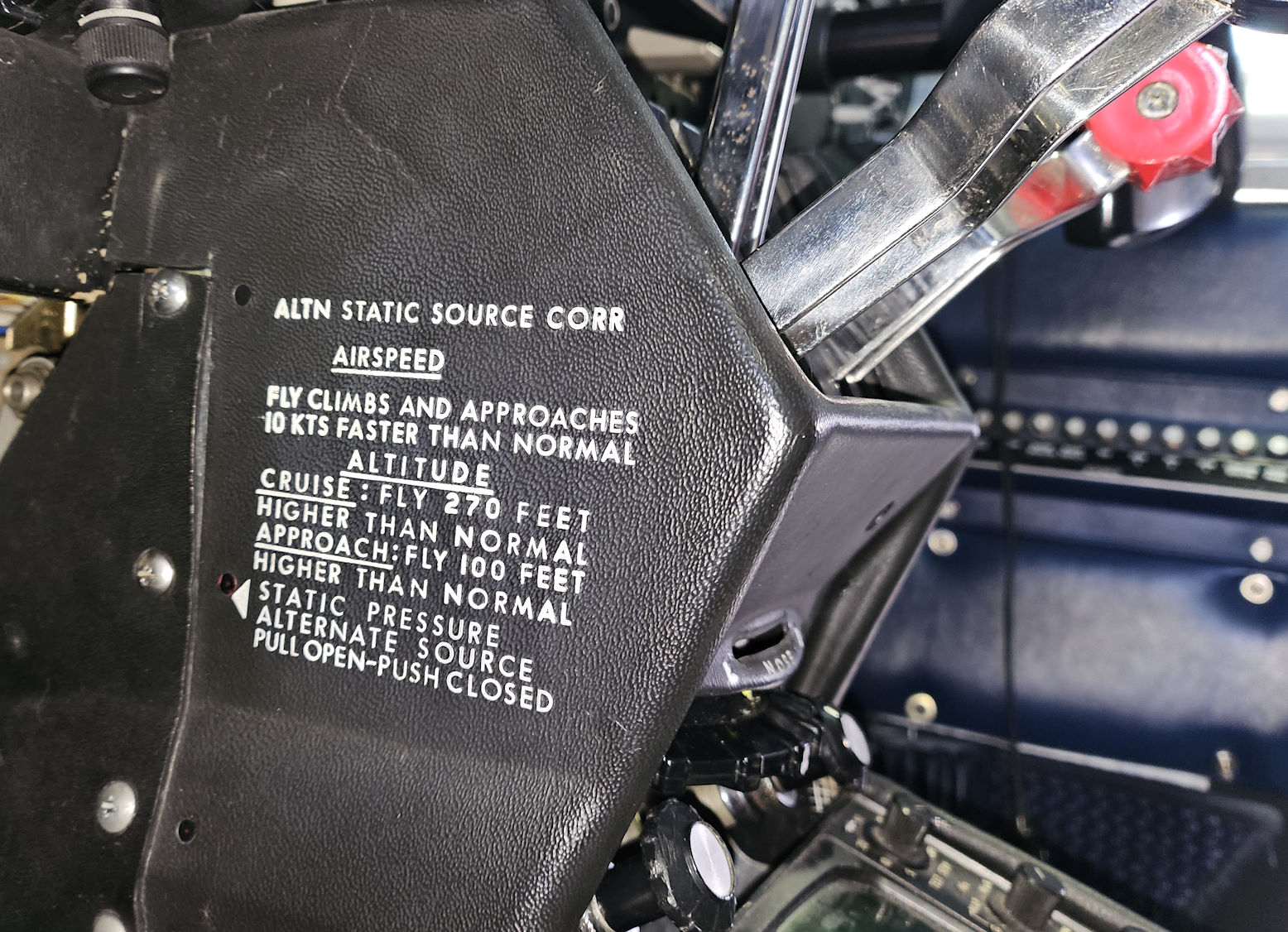

This was a good question about something I had forgotten, even though it was posted literally right in front of me. See the picture! I tested it in low level cruise. Airspeed dropped by ~10 kts, altitude increased by 150 ft.
