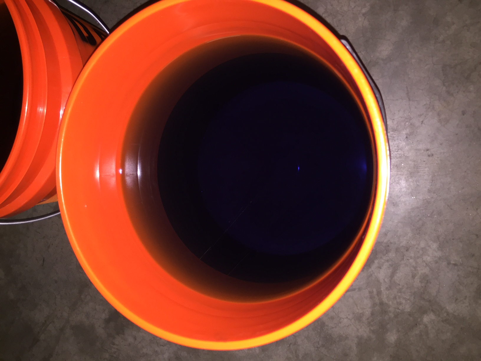

Hopefully the attached picture shows up. What you see is the separation of one bucket that came out of the tank (there were 5 more with probably 1/3-1/2 of the bucket "separated"). Avgas is on the top, the dark line is where the water (or whatever it was) separated to the bottom.

Looking at the pic, I'm not having an aha moment either, but if it was water it would be clearer, my guess is you got some of the "bottom of the barrel" at the self service fuel stop. My best guess is rust sediment from old in ground tanks. Hopefully the new fuel will flush it out and you will have no problems.
