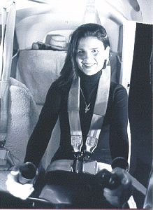

Thanks for the reply Jeff, I really questioned if they would be comfortable or not. In the pictures I have seen they look very restrictive, like the upper belts are rubbing up against the neck. My concern with BAS over other 4 point systems is the single attachment point for the upper belts. This looks really uncomfortable.

Well Herb, that has not been my experience. I thought the same as you, and wouldn't have done the installation either based on appearence. As I said, my plane came with them already installed, so I had to try them out and I have found them to be quite comfortable, no hanging on your neck at all. I feel they are a good upgrade, but as they say, YMMV! You might find a plane with them installed and try them out, who knows, you might like them! If you find yourself out this way, look me up, you can try mine.
