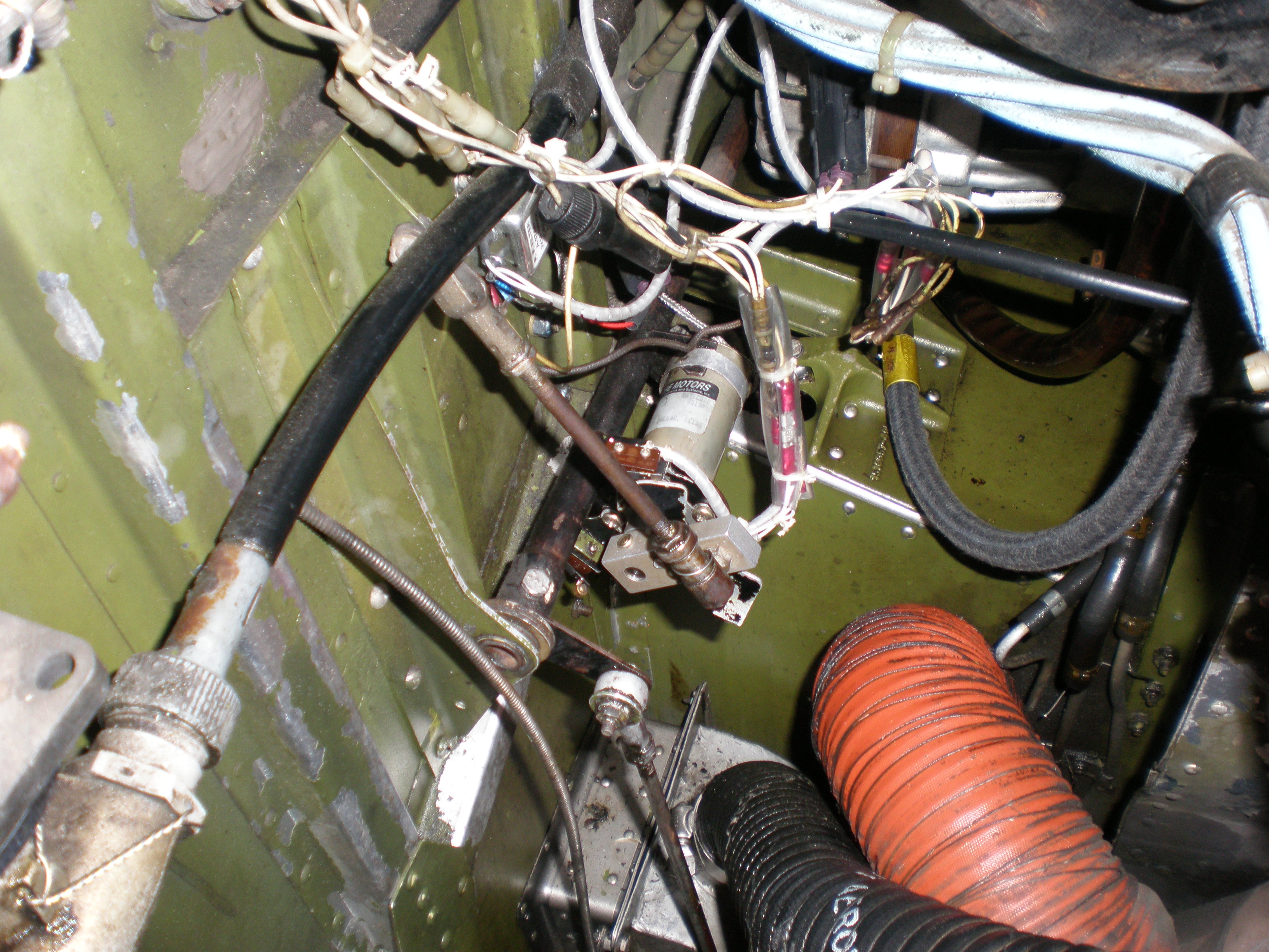

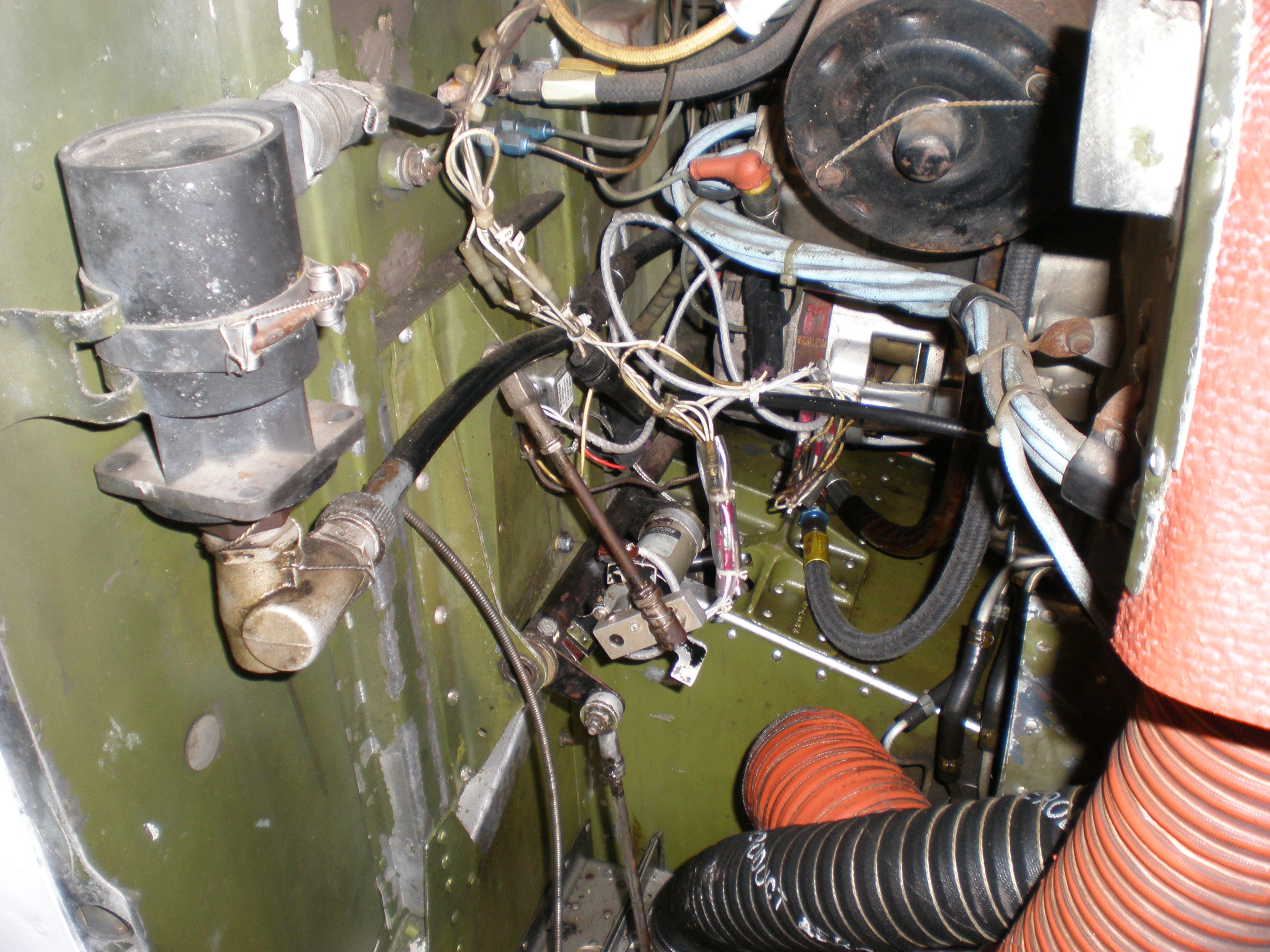

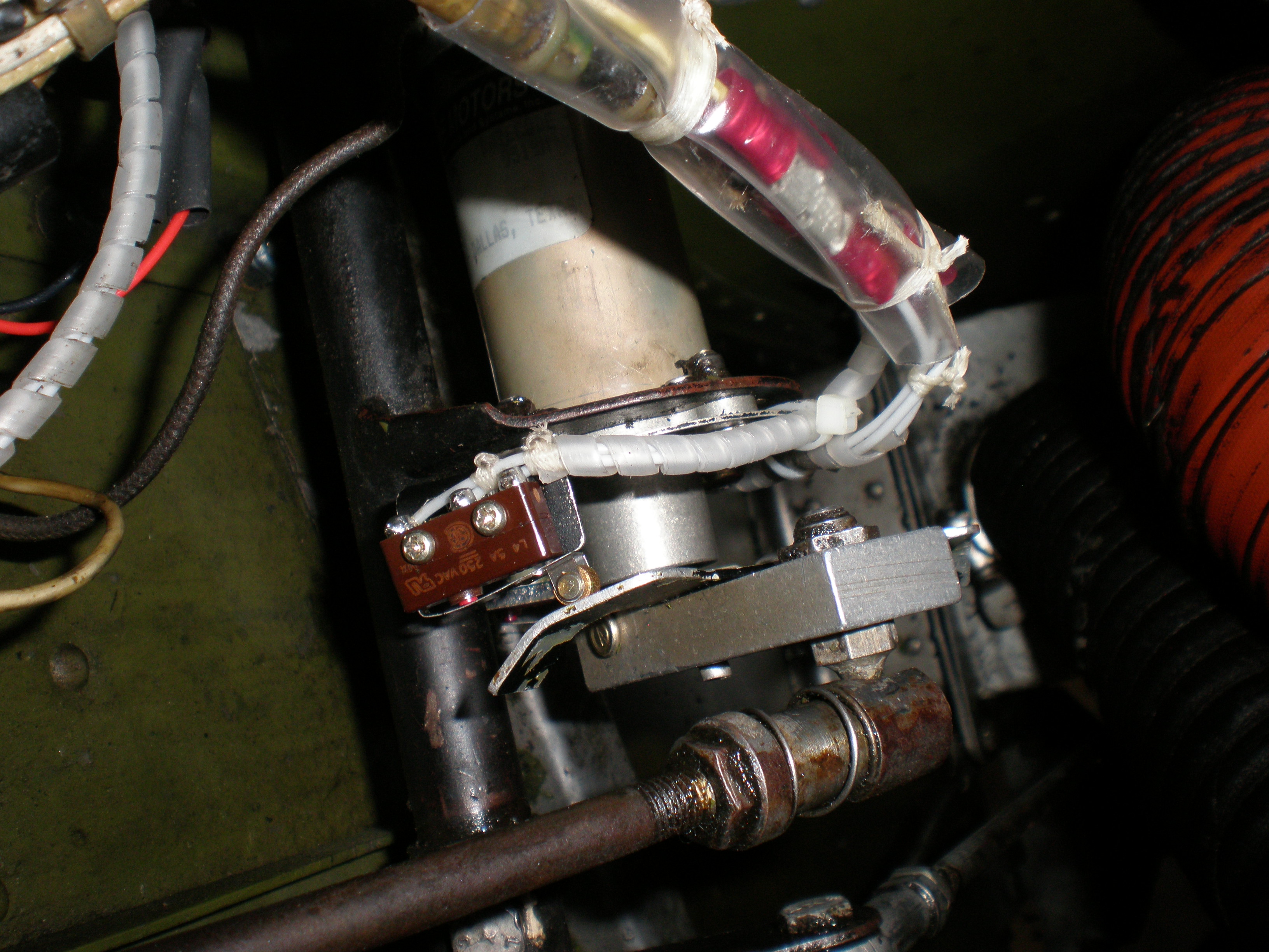

I got tired of just patching the wiring for the front engine cowl flap limit switches, and replaced the whole rats nest. I used 1/8th spiral wrap to bundle the wires, and tied them off to the microswitch bracket for a strain relief.

This is good. You have solved a problem, for you, and given good illustration on the solution so that others can follow your lead.
This is the kind of informational posts we need.
