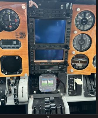

See cutouts below photos for consideration
Currently I have a stratus 2S (w external power and antennas) mounted behind smoked piglass. Its status LEDs are visible in flight.
Why do I have this, as backup to the unlikely event everything goes kerplunk.
If needed I could still use iPad etc and keep going.
Consideration above throttles -
In my mind, right where engine monitor of any sort could go,
To put anything just above throttles
requires re-locating the stratus 2s ...somewhere.
I can probably find somewhere.
Over to right behind overlay is/was an opening holding an old radio,
so it might mount on back ...perhaps.
Or maybe just drop stratus 2s backup?
Option 1 - Simplest install - right of Shadin
Remove EGT
G4 goes where EGT currently is, to the right of Shadin.
Not a direct line of view, but pretty close, and probably good enough.
Option 2 - G4 above throttles.
Remove EGT
Re locate stratus 2s ...somewhere.
Use same or similar panel w 3.25 cutout
mount G4 right over throttles.
Maybe slightly left, to be clear of RPM which sits higher up
Option 3 - JPI 790 nice big digit display / scanning mode or stop
Remove EGT
Re-locate stratus 2s ...somewhere
Install JPI 90 right over throttles
Remove or leave shadin in?
Option 4 - Upper left of pilot panel
Not sure curing 3.25 into overlay panel would go perfect;ly,
but stuff in that area is no longer used, OM, MM, IN, panel/speaker etc.
Far way from engine gauges, but worth considering

You changed my mind with the photos…Since the G4 is STCd as primary EGT, put it to the right of Shadin FF as in option 1 leave everything else alone. Wire in all the sensors you can, and enjoy!

That's probably the way I'll go G4 where the EGT is now
I find the G4 vibration analysis and percent power indications ...interesting.
Even to the right, the vertical temp strips for EGT and CHT will be fine.
I understand they change to yellow or red if anything starts to move out of range.
I have never seen one powered up. Reasonably bright and easy to see at a slight angle?

My G4 is mounted right able the trim wheel.
Unread 12-30-24, 11:36 AM
