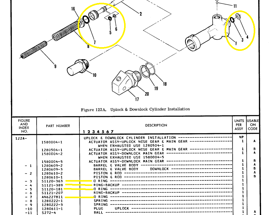

Can't find the break-out for the up-lock actuator in the IPC - says see Fig 46... in Fig 46 .
Need cross ref's for MS28774 teflon packings .
Need alternative PNs for : S1120-363, S1120-181, S1121-389, S1121-207
Thanks!

AN6227B series is the cross ref for the MS28775 orings.
Aircraft spruce has them.. the whole series...

https://military-fasteners.com/ms-se...rings/ms28774/

Thanks a Randy, you're far more patient than I with dealing with part searchs !
Okay, so the door actuators use standard MS28774 & MS28775, that's easy.
The Cessna PNs are only found on the up-lock / down-lock actuators :
