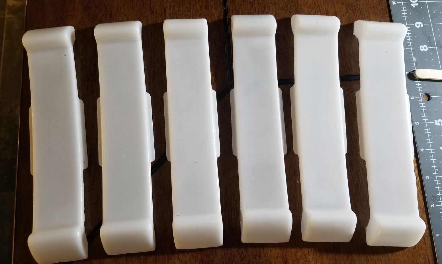

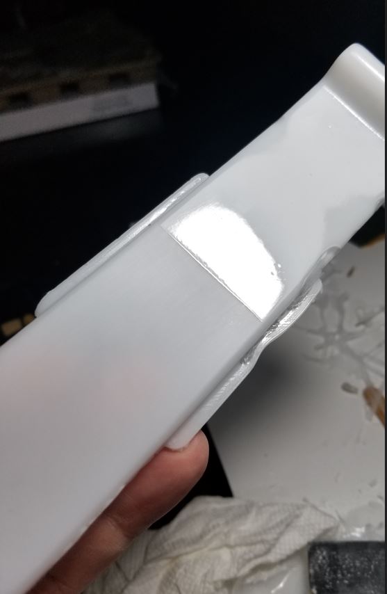

Ill have a few of these dome lights ready to ship soon. I also tested a glossy look and a frosted look on a failed part to see if that is something people would like to choose. I also finally matched the same opaque white of the original. Curing time and post processing is what is taking so long for the part to be able to handle the interior temperatures of our birds.

I'm currently looking for a material solution... the 6 resin casts in the picture failed the heat deflection test. Basically the dome light will sag in the dead summer heat. I'm working on a PETG or ABS solution which both of those material can withstand upto a 200F during the summer heat.
