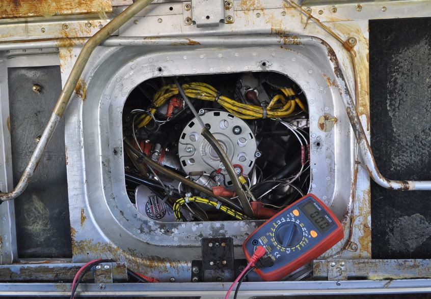

I wonder if you could buy one off a parts plane, like that yellow P-model that's being parted out on here? I attached a pic of the access hatch on a pressurized model, I have no idea if its different on a non-pressurized.
