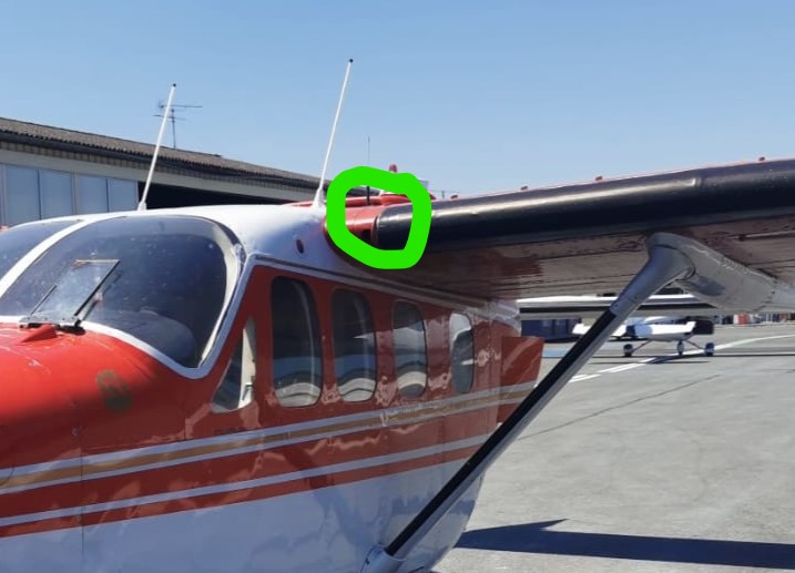

I suspect the original airspeed indicator on N119XU was replaced with a remarked one when the Robertson kit was added, and the replaced again when the panel was redone with Aspen. You can tell by the panel cutout above the indicator that it's not original. Robertson STOL did not add a second airspeed indicator - they replaced the original factory one. A Robertson STOL airspeed indicator will show a stall speed (bottom of white arc) of about 50 mph or 43 kts. Robertson kits haven't been installed in decades - the R/STOL kit certainly predates Aspen avionics. One other way to tell if a plane has a real STOL kit is to look for the small leading edge fence at the wing root where the STOL cuff meets the old leading edge. I've circled it in the picture of N199XU below. I don't think N62NA has that fence.

As far as N119XU vs N62NA, I'd put a deposit on N119XU right now. It looks great on the surface, it has low engine and prop times, it's in annual, it's flown recently, it still has the heated windshield plate, it has an updated panel, and it's already in Europe.
