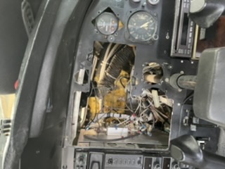

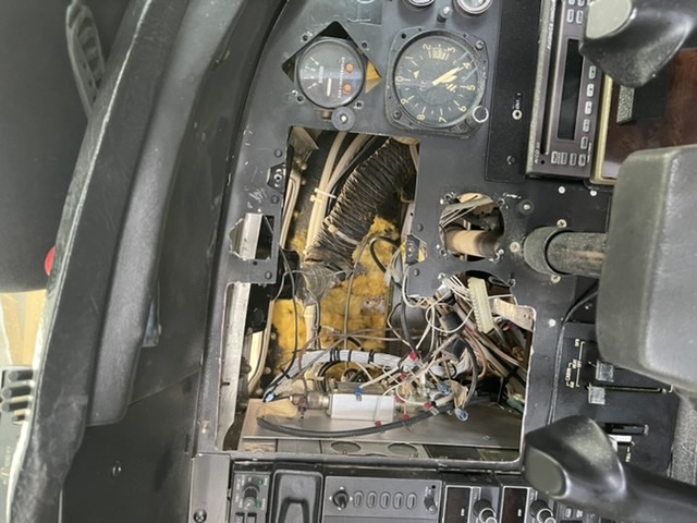

My electric international mvp 50s are here and the panel is cut. Going to tilt it about a inch to inch and a quarter towards pilot side for easy Visibility.
