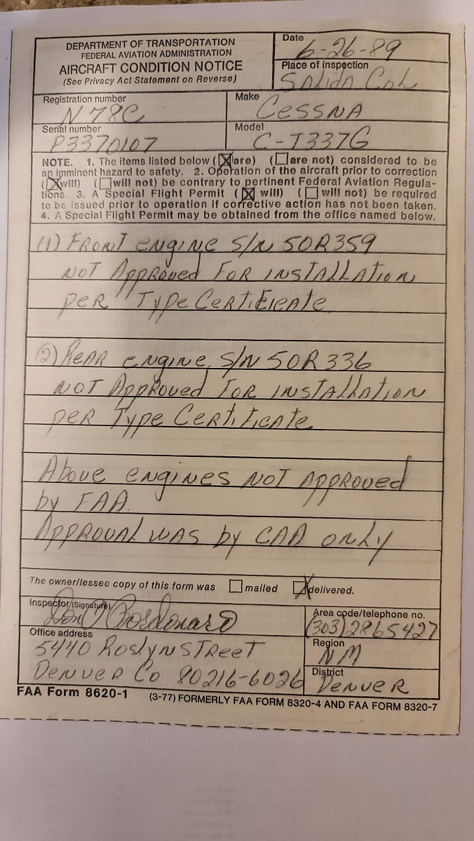

Attached is the Aircraft Condition Notice issued by the DEN FSDO back in 1989 for N78C. The logs show that in the end, the owner at the time elected to replace the engines with Continental TSIO 360's.
The records that I have also show that the owner at the time engaged in legal action against the provider/dealer for the engines. From what I can see, the record is inconclusive and I am not sure that any compensation was paid.
PM me if you are interested and I will be more than happy to mail you all of this. It may be of assistance, or it may not.

Quote "Attached is the Aircraft Condition Notice issued by the DEN FSDO back in 1989 for N78C"
Approval was by CCA only - Canada Civil Aviation
1967 337B

Frank:
The certification authority for the RR engines was the CAA (Civil Aviation Authority) from the UK.
Richard

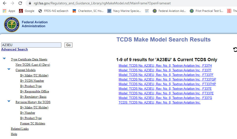

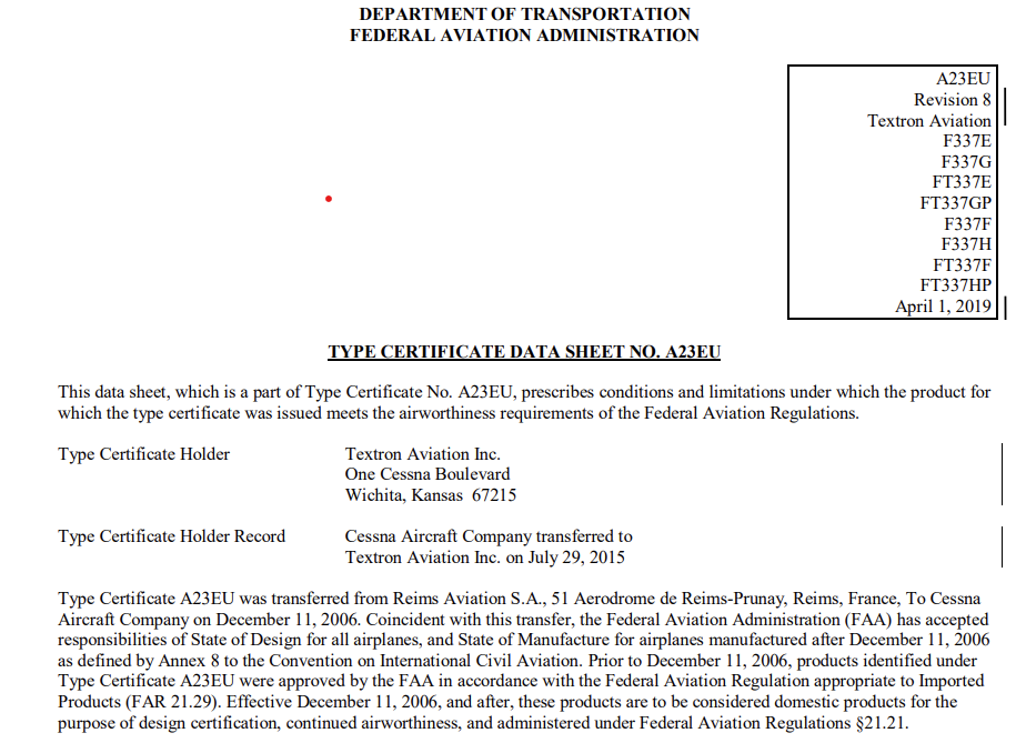

The Type Certificates for most of the Reims-produced Cessna aircraft were transferred to Cessna in 2006. This allowed owners of Reims Cessnas to register their aircraft on the U.S. N-number registry with minimal difficulty. In the eyes of the FAA, Reims Cessnas are “considered domestic products for the purpose of design certification and continued airworthiness” per Type Certificate A23EU.

Be sure not to show them a copy of Type Certificate Data Sheet A23EU that I posted links to a couple of messages ago, or they might go, "Oh No problem here. Have a nice day." Then you would have to find another dead horse to beat.

I guess I don’t understand exactly what that a23eu means. Trust me, I’m open to any solution. So far I’ve found that just because it’s logical, doesn’t mean it’s acceptable. I will happily research this avenue more.

The TCDS lists the parameters and equipment for a type certification. I have attached the top part of the TCDS for the French built 337's.
This does not help. The TCDS for the FT337GP lists the Continental TSIO 360C. See the second attachment.
In fact, no French built 337 was equipped with the RR engines when they came out. They were equipped with Continental engines. All Reims did was assemble kits supplied by Cessna under the Cessna TCDS which has always listed the Continental engines.
