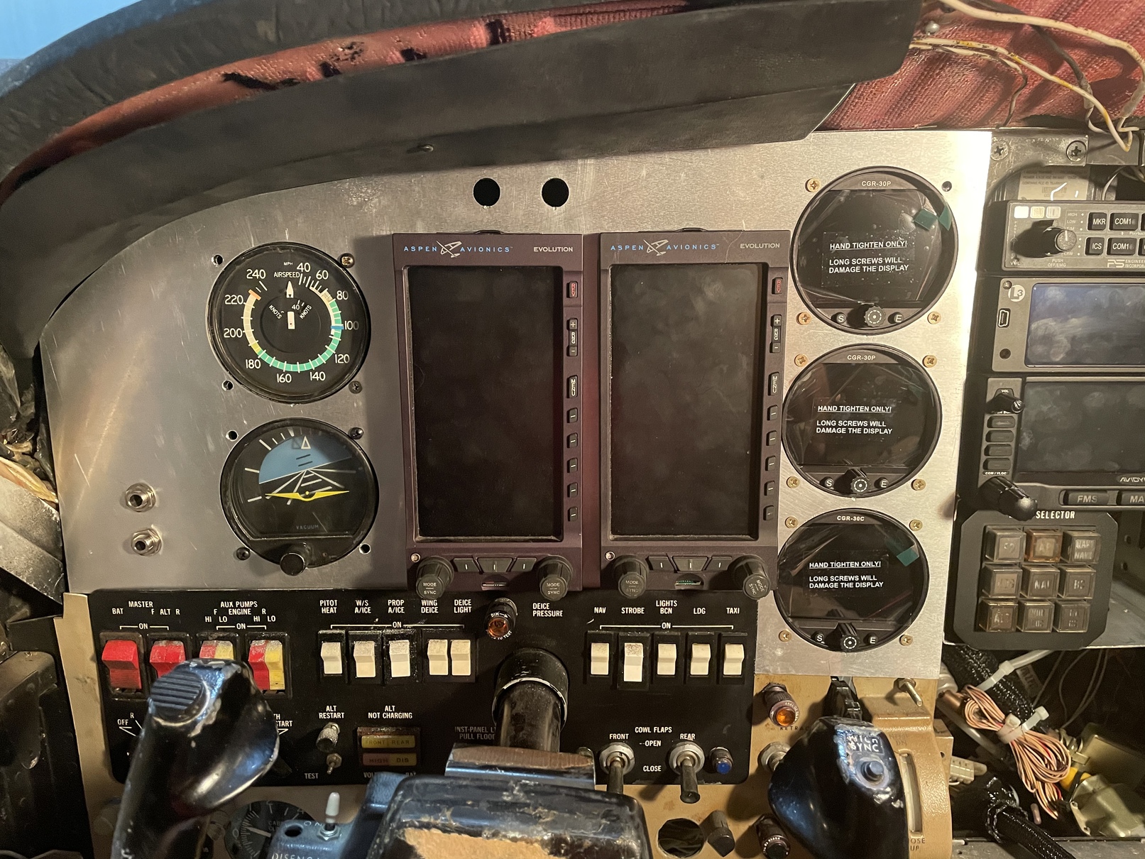

Redoing our panel in 58C.
Looking to get as much input from others experiences as possible.
After about 5 tries we are almost there with the adjustments needed to get it just right.
Going with EI instruments as a primary replacement on the pilot side.
Will post pics in the morning

EI product.
Did quite a bit of research and the EI product is well respected.
We are based at the old Norton air base would love to show you what we have done so far.
Still trying to upload pics maybe I can post a link to google drive of our progress.
Last iteration of the panel cut should be done next couple days.
Went with dual Aspens, kept the 400 autopilot which was sent out to Bevan for inspection / 8130.
Our plan is to have the 3 displays from EI on the pilot side where nav indicators used to live.
Feel free to contact us.
213-308-7077
Will keep updates going here for others to read.

EI instruments
Still working on the layout.
No paperwork completed yet
Just got all the instruments situated last night.
Attaching pics after I create the link.
File Type: jpeg 45AE4144-5D9B-417C-BA11-F24D9B23FE68.jpeg (884.8 KB, 1703 views)
