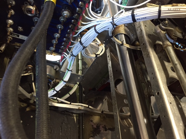

On my 67 B model that is the QB1 wire. It comes from a 2 amp breaker. Without the oil dilution system the wire capped off. I believe that breaker also powers some instruments.
Is there anything that doesn't work in the panel?
Do you actually have the oil dilution switch/valve?
This is an easy circuit to trace. The bundle from the circuit breaker panel goes forward and turns around the edge of the lower panel. It joins up with the bundle coming to/from the front engine. The bundle is right behind the lower switch panel. I would start by identifying/tracing the QB1 wire. I don't recall what other wires are hooked to the load side of that breaker. I think it's the engine gauges. It's worth looking close at that area. I've included a pic of the back of my engine inst. panel that I just finished cleaning up the wiring. The spade terminals can get loose and cause problems.
A methodical approach will identify the problem. I'm not excited about just throwing parts at problems like this.

On my P model the cb is labeled "oil dil , tach, oat". The tach and oat both work even with the cb popped so I think that only the oil dil is connected. I changed the cb just to eliminate that but no joy. I don't believe that I have oil dil on the plane. I have tried to trace the lone wire from the cb but cant ID it thru he firewall. It has to go to the aux pump and I am looking there now.

Okay, so someone has gotten creative behind the panel. I would tend to disregard the breaker labeling in this case. The wire is going somewhere. You only have two and a half options for the popping breaker. There is either an excessive load to whatever it's hooked to now or there is an intermittent short. The half option is a bad breaker that trips all by itself. That is a much less common situation. You should also be on the lookout for something that was disconnected and the wire left dangling.
