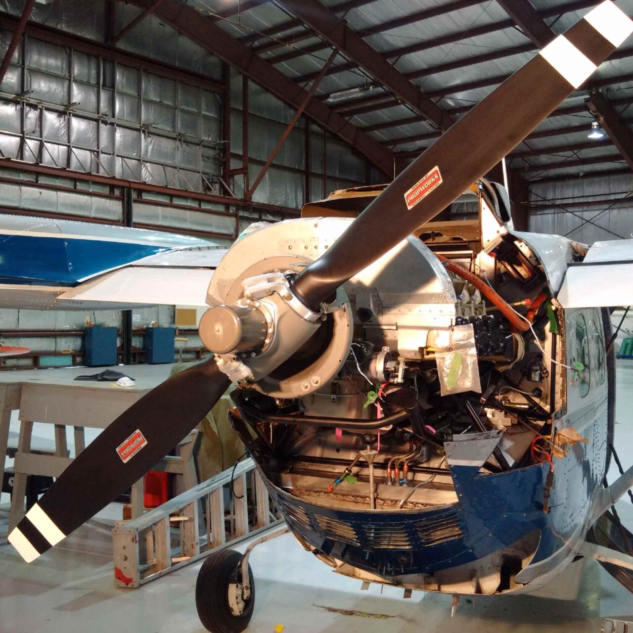

Fresh prop installed - should be ready for ground runs tomorrow.

Unread 06-02-15, 05:02 PM
Looks good James, best to the test runs

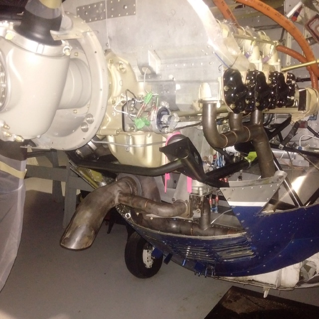

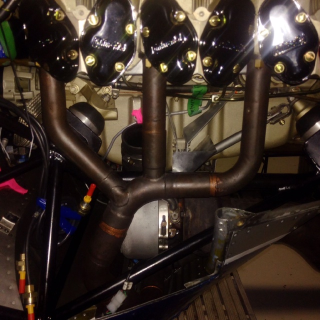

Making adjustments still.
Some more photos below - beauty is in the eye of the 337 owner...
ID:	1590   Click image for larger version

Unread 06-10-15, 08:52 PM
Exciting stuff Jim
