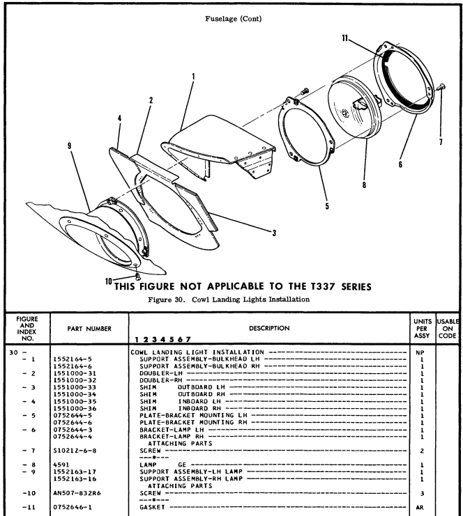

I think they are both Par 36, but the support assembly points the taxi light down lower than the landing light.

If you are replacing them with LED bulbs, there are different bulbs for the taxi and the landing lights.

The PARMETHEUS™ G3 PAR 36 LED LANDING & TAXI LIGHTS are probably what you're looking for. These are STC'd so there shouldn't be a problem with your IA approving them. The STC documents are available via a tab on this page (see item #66 and #74 on the STC/AML). There might be other brands of TSO'd lights out there also ... ?

Thanks. When I went to various resellers and punched in the application (69 Delta) some of them would offer up a PAR 46, where others would state as you just did. Since they are clearly not interchangeable, it was a bit of a head-scratcher.

AeroLEDs Sunspot 36 series is also PMA’d for our 337s. See PMA supplement 7 on their site.
