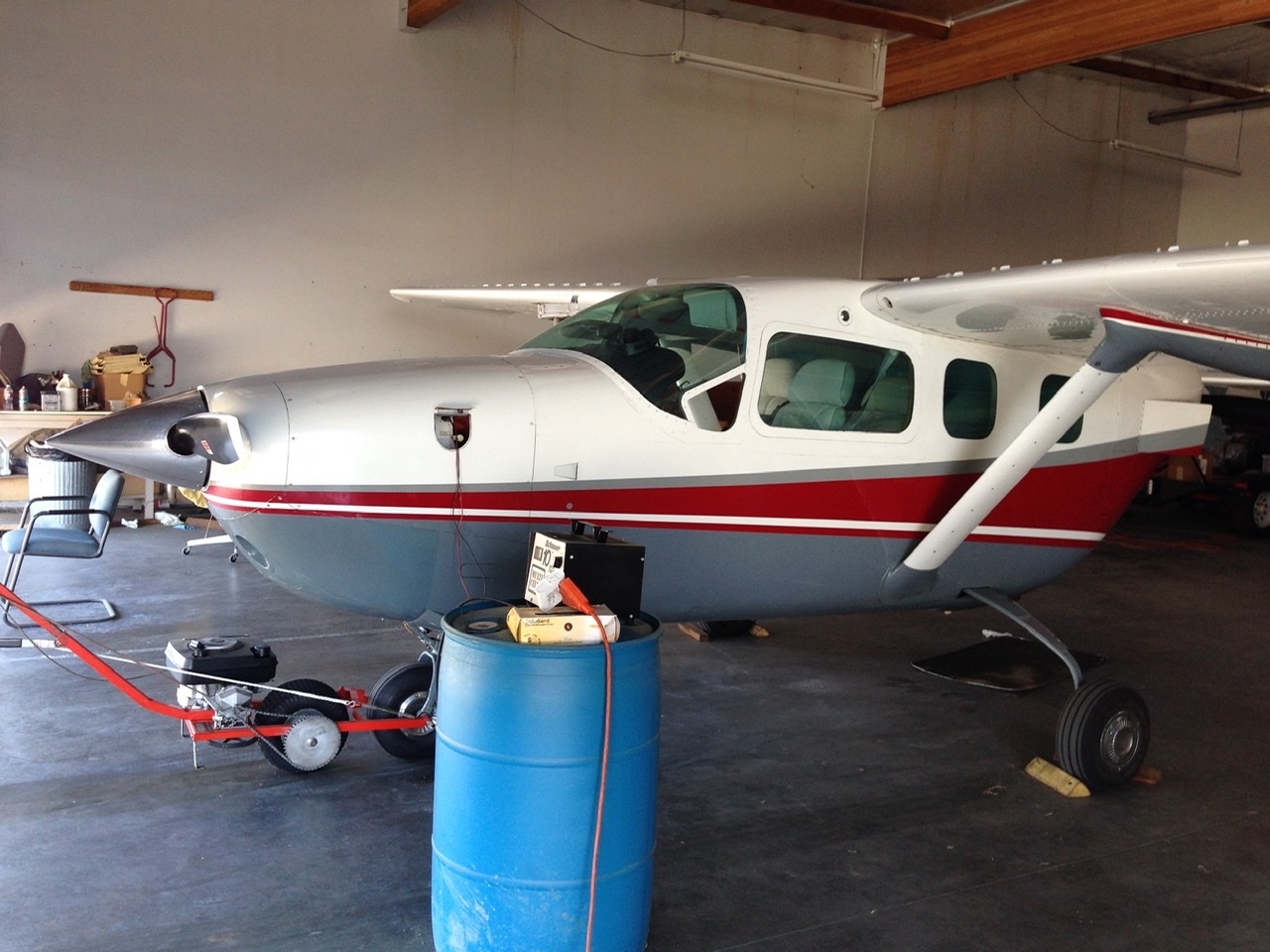

Here is a photo of a 337B that was for sale jan/2021
Looks like he did without posts or plates.
Was it legal? idk.
I do remember reading somewhere the concern was that the windshield would/could pop out during flight.
but i think OEM wind shields were 1/8” thick at the time but now they are available in 1/4” and less likely to come out.
https://ibb.co/Fb85GrD
337B
Philadelphia PA

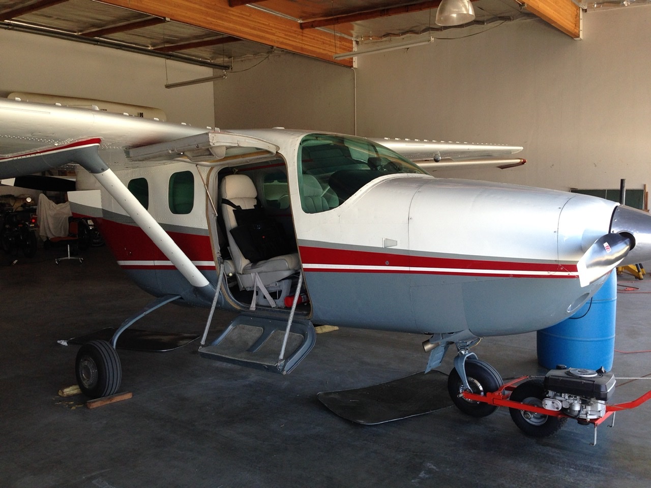

My center post was removed before I purchased the plane in 1995 (1977 337G). I know there is paperwork for the removal, I think a 337 form with some accompanying engineering data. I don’t think it was an STC.
I am not near the logbooks but will be so on Sunday.
I would be glad to either post them to the forum or email them to anyone who is interested.
No sense in going through the extra expense or re-inventing the wheel if it has been done previously and accepted by the FAA
Unread 08-09-22, 04:44 PM
kbecker kbecker is offline
Join Date: Feb 2009
Posts: 116
Please see the attached pictures
