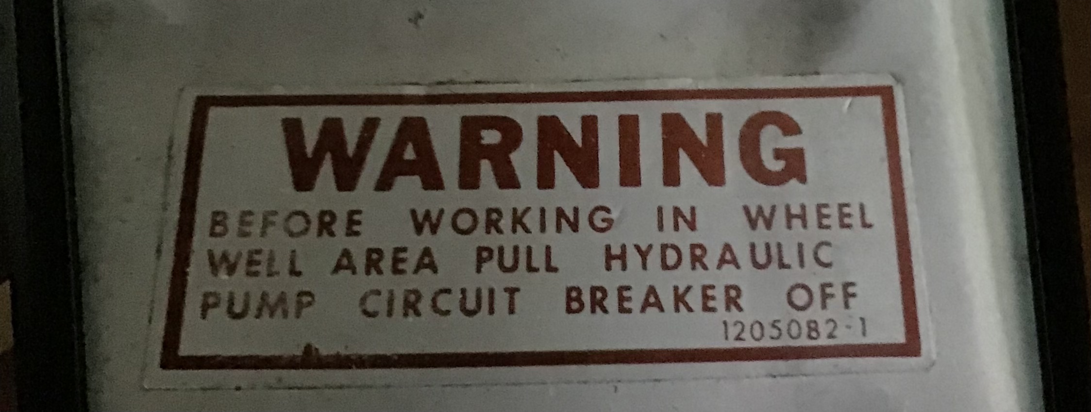

Attached is a photo of the placard in my ‘77 G model gear (one on underside of each nose gear door and 1 on inside of each main gear spring door).

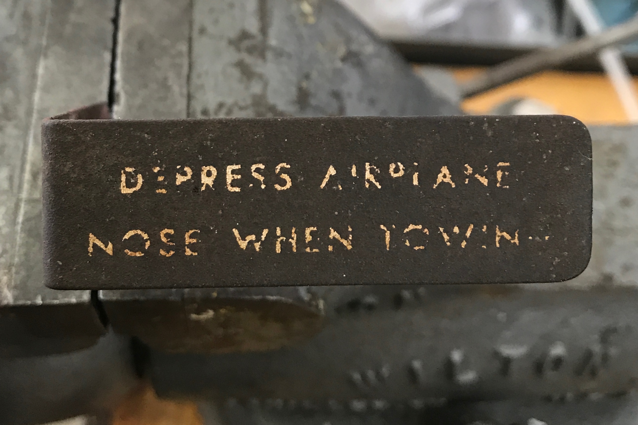

Would this be the one your are thinking of. Off of my P337H. Before restoring it.

OhioSkymaster, if you're looking for the placard about the hydraulic pump circuit breaker, I had some made for my plane, along with a slew of other placards also.
The guy that made them would still have the template and can make more of them if that's what you're after. He's available at dean@pipts.com.
MD83Driver, I don't recall seeing that placard. I remember reading about it though. Where does it go?

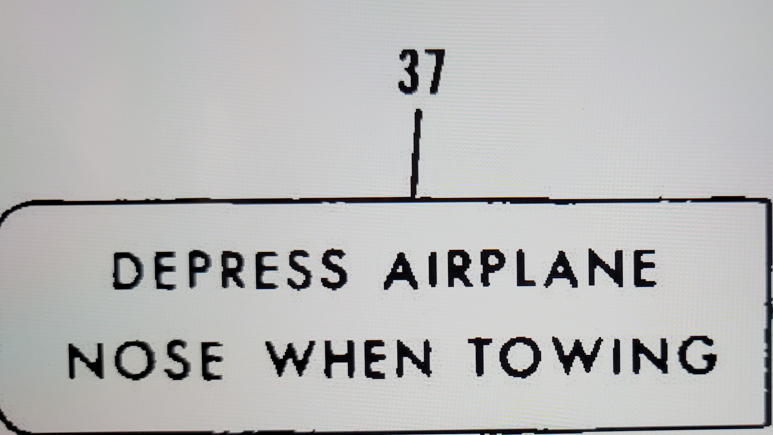

Rick, The placard is shown in fig.2 Item 37. It is not shown in the parts catalog of the nose strut. Here are pictures of the installed placard as it was on my plane. These are the only pictures I have. Ray

Thanks Ray. Figure 2 is where I must have seen the placard.
I'll have to check whether it's there tomorrow. I'm thinking it's not...

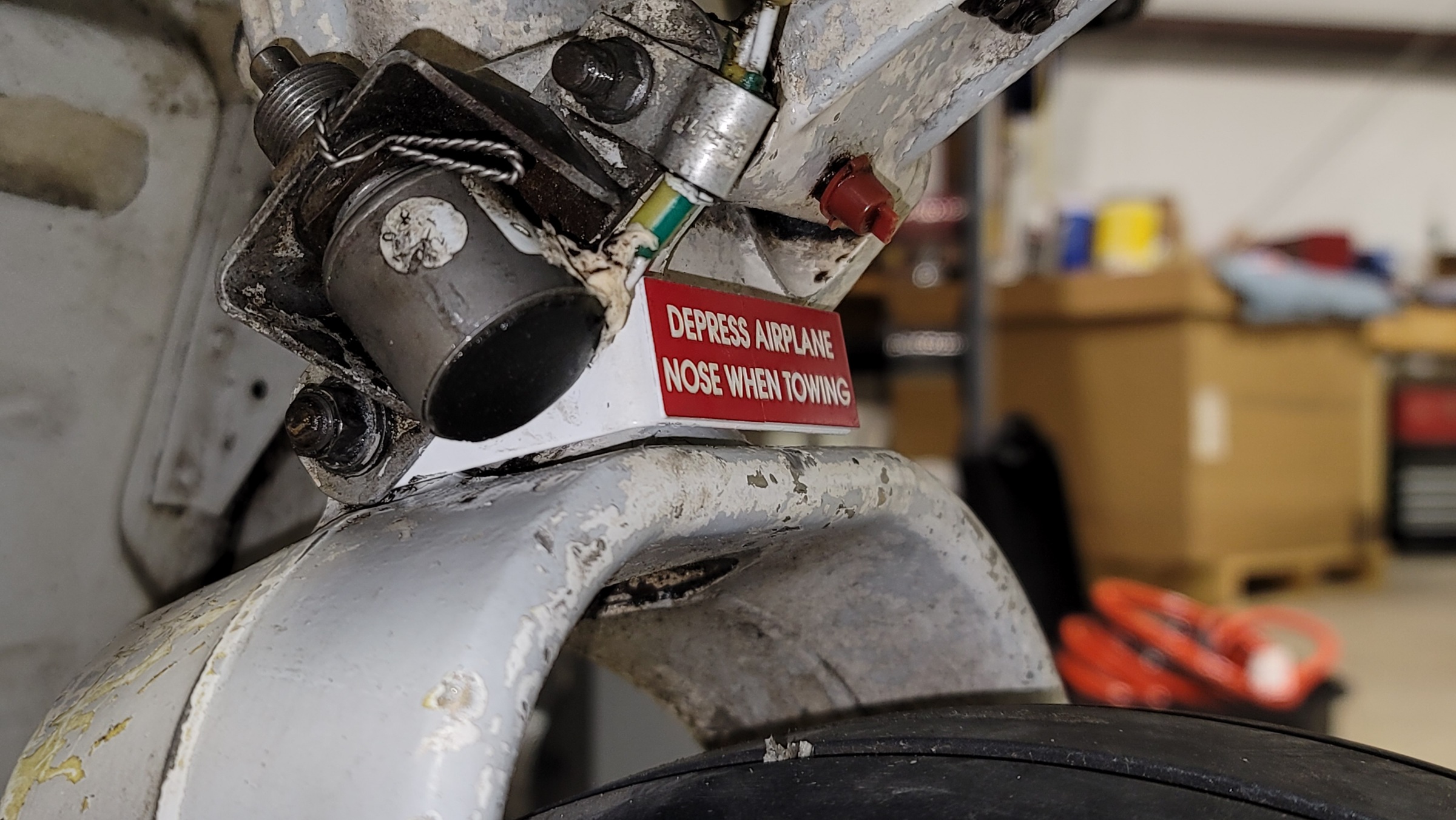

Unread 01-19-22, 12:12 PM
Join Date: Apr 2019
Location: KLOU
Posts: 194
It's there! I'd never noticed it. Something else to restore.

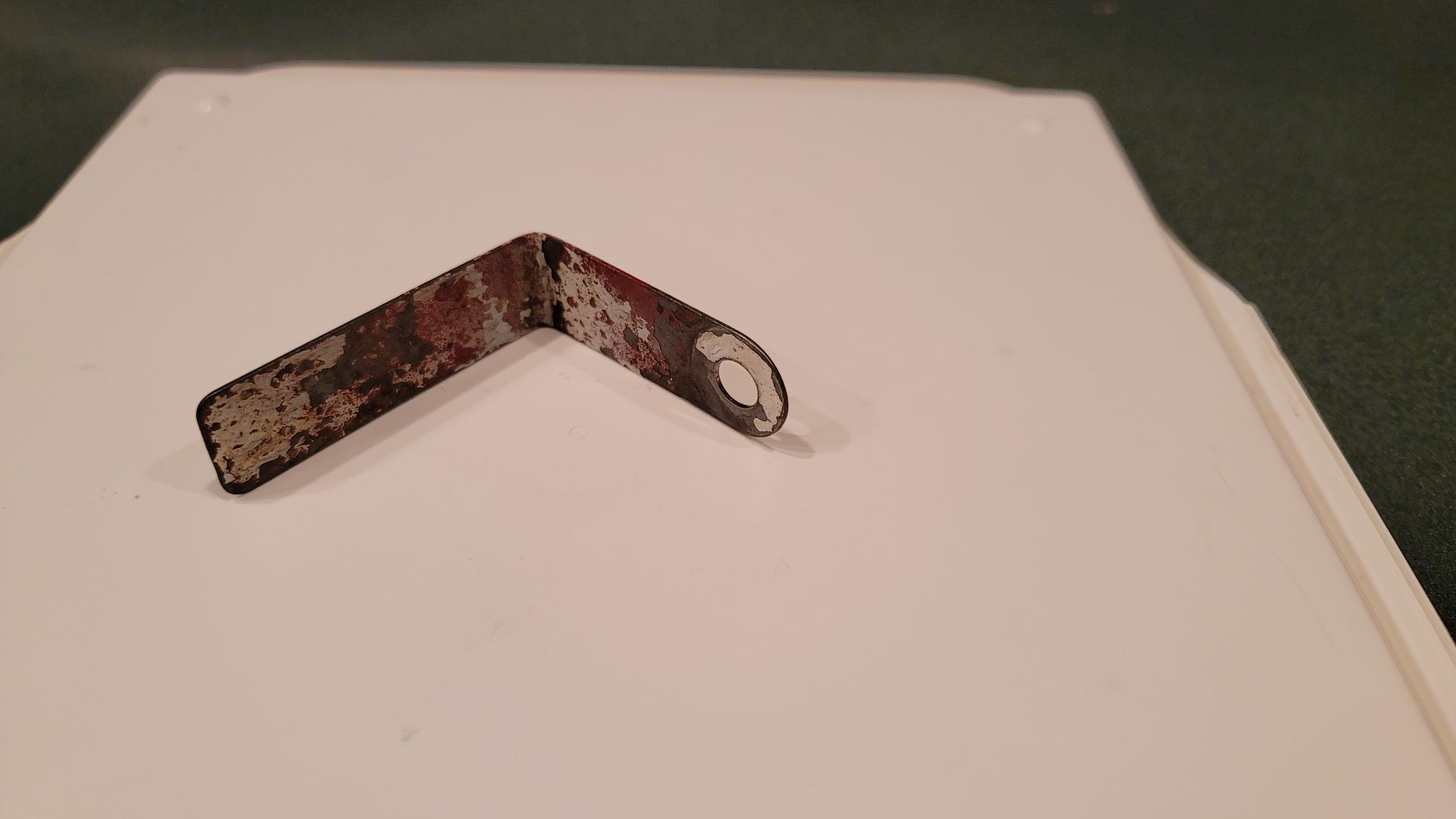

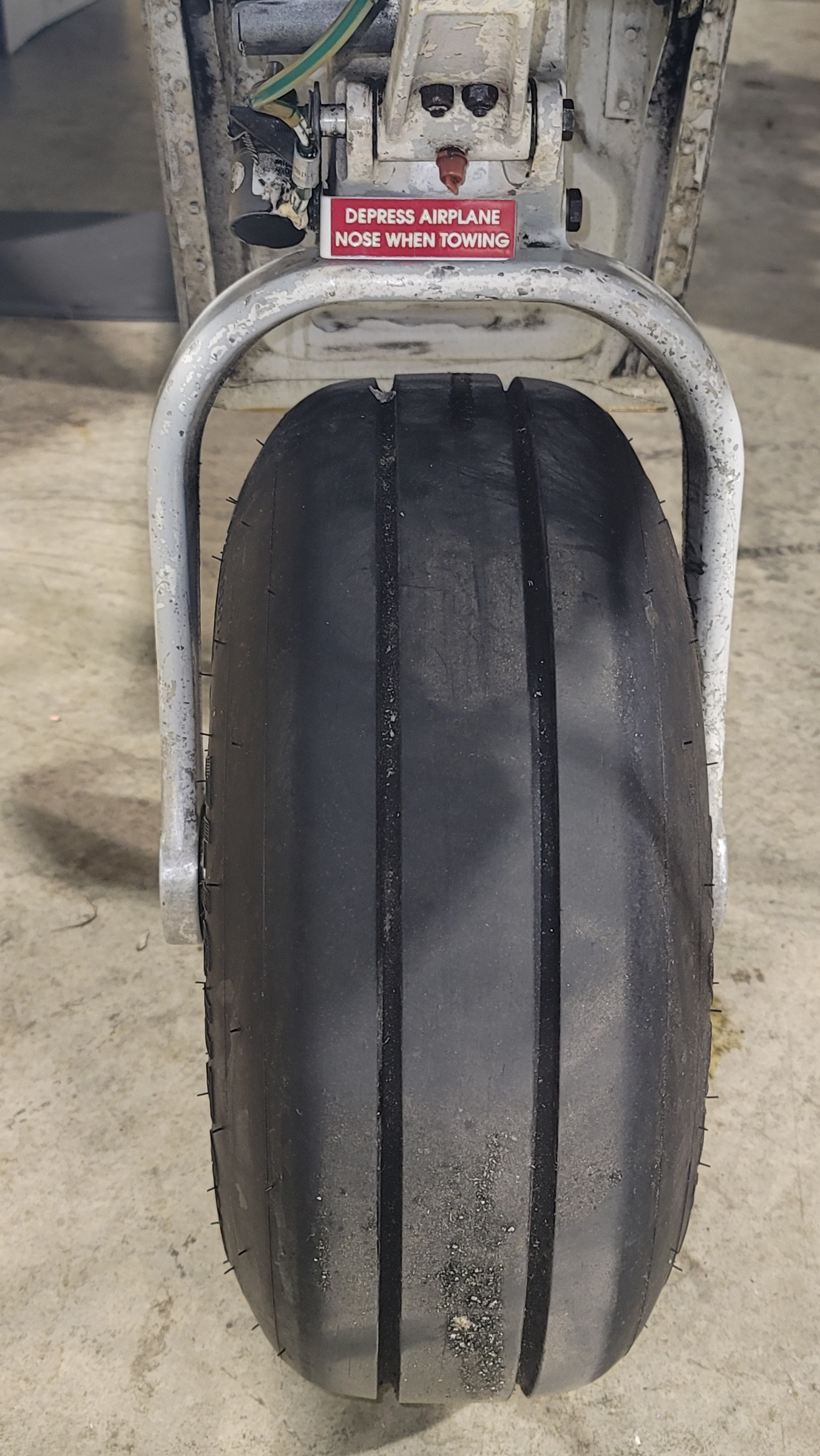

Since the bracket for the "DEPRESS AIRPLANE NOSE WHEN TOWING" placard doesn't appear to be in the parts manual, this is for any DIYers wanting to make their own.
Here are the dimensions:
Stock - 0.75" x 4.625" x 0.0435"
The 90-degree bend occurs at 2.125" on the leg with the mounting hole in it.
The mounting hole diameter is 0.325" and is centered 0.3875" from the end.
The front face on which the placard mounts is 2.325" wide by 0.75" high.
I went on a search for why this placard exists. Like OhioSkymaster and MD83driver, I couldn't find anything in the Parts Manual about it. I couldn't find anything in the Airplane Flight Manual about it either. There is a Caution statement in Section 2-General Handling-Towing that only states: "Depress nose of aircraft when towing." No explanation beyond that.
I discussed this with my IA, who believes it is related to a self-centering mechanism that centers the nose gear prior to retraction to prevent damage during retraction. He said if the oleo strut on the nose gear is extended to the point it has locked into the self-centered position, and the nose gear is then turned, the nose gear linkage would be damaged. Makes sense.

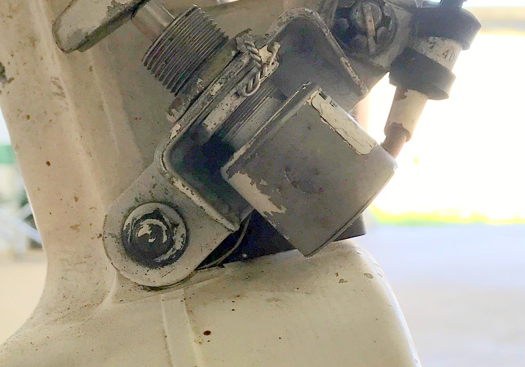

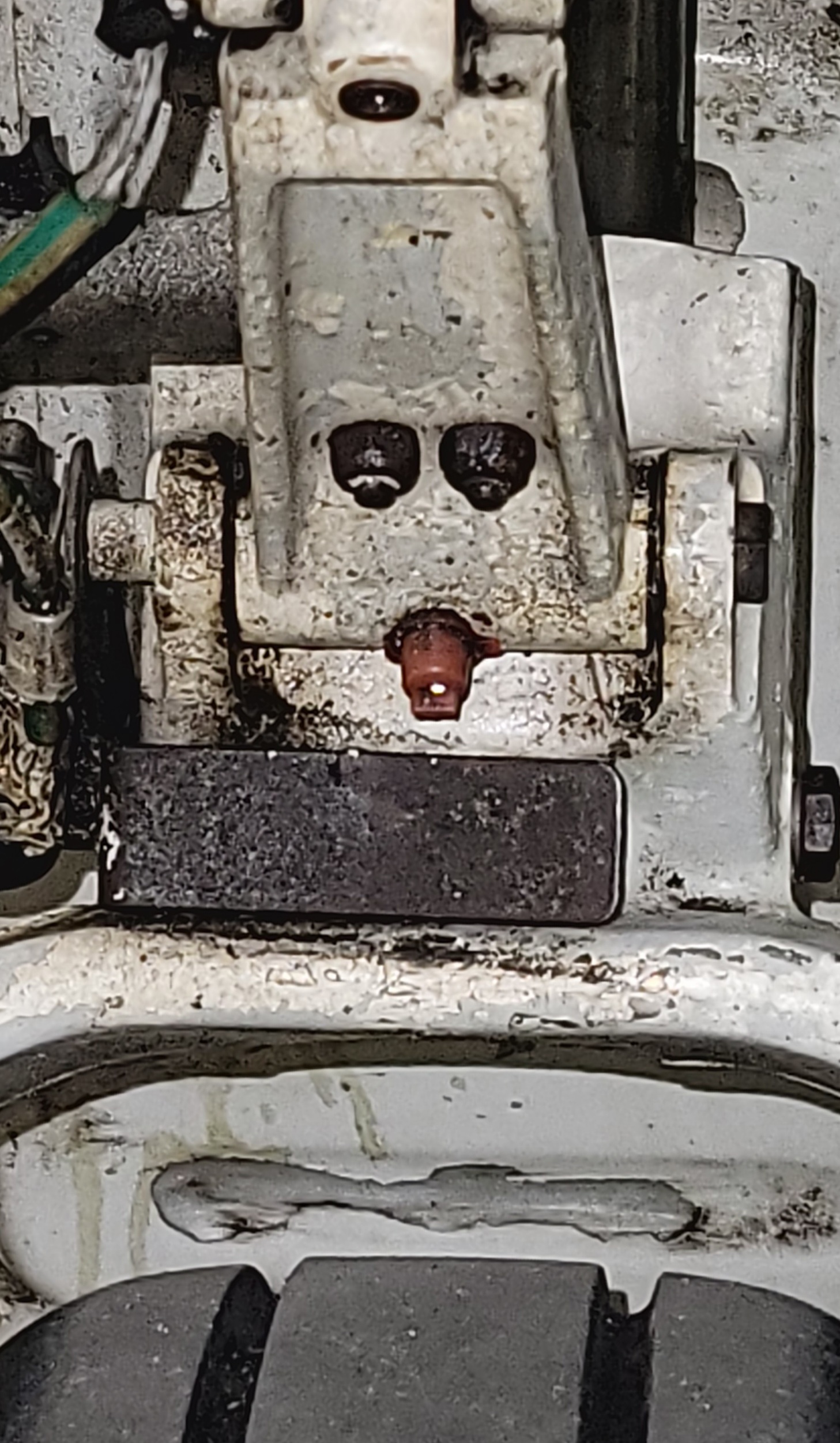

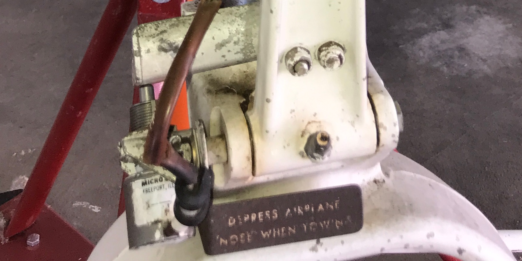

Closing the loop on this project.
The bracket attaches to the inside of the lower, aft bolt that holds the nose gear limit switch bracket.

Unread 03-08-22, 01:04 AM
Join Date: Nov 2018
Location: Ohio
Posts: 141
You might want to inspect those wires from that squat switch in your photo. Mine had the insulation worn away exposing bare wire. I removed the wires to the terminal strip on the left hand side of the nose wheel well, used shrink wrap on each individual wire then used a piece of shrink wrap to encase both wires.

Unread 03-08-22, 08:08 AM
Join Date: Apr 2019
Location: KLOU
Posts: 194
Thank you, Dan. I'll get those wires wrapped up.
