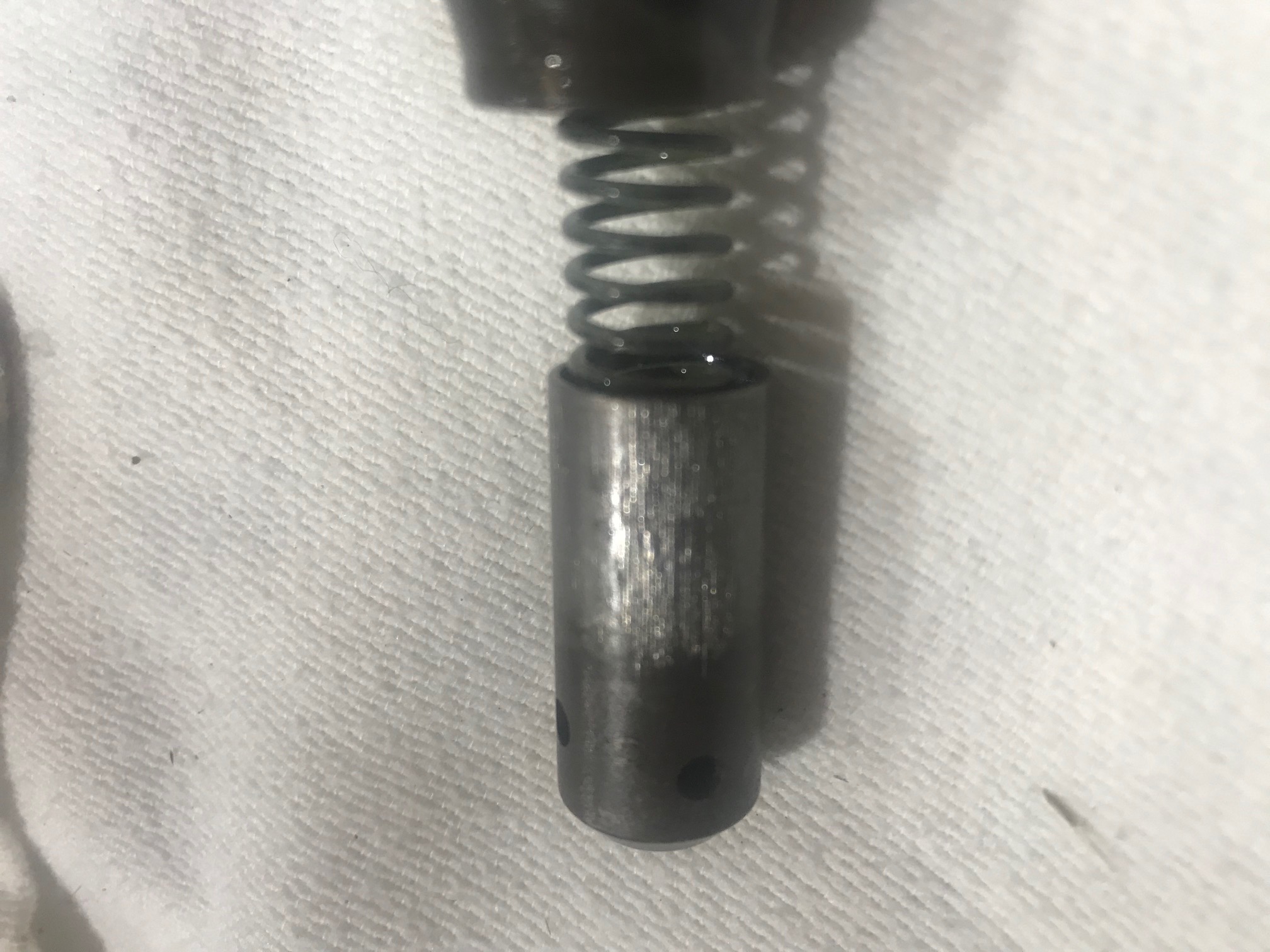

I am totally planning on doing as much as I can. I am a highly capable mechanic/engineer. The issue is that I am in Iowa, and the plane is in Oklahoma. I have been troubleshooting with the mechanic down there. I asked him to pull the oil pressure relief valve as it is located before the oil cooler. So if it is dumping oil, there is less oil getting cooled leading to higher temps. See the attached pics. Needless to say, this was a good call. Cleaned the port, ordered the new style adjustable relief valve. Since I will not be back down there for a week or more, I am going to have him pull the oil cooler and send it to QAA for an exchange.
On the propeller side of things, we have to keep in mind that constant speed props work just the opposite of feathering props. CS props rely on pressure to INCREASE the pitch, and feathering props rely on pressure to DECREASE the pitch. That is why if you have a full engine stoppage, you can still feather the prop on a twin. In addition, the governor has a high pressure pump in it, so as long as it gets oil, the governor will boost the pressure to the prop. The SUPER NICE guys at H and S propeller have worked on the props in the past so I called them. He said it is very common to have to adjust a screw on the side of the governor to allow the prop to de-oil faster in feather mode. He said that my prop feathers at a higher RPM because the counter weights in the prop are helping push the oil out. He gave me a test to run, but wants me to send him a picture of the governor so he can walk me through the adjustment.

I think you are on the right track with the oil pressure relief - that thing looks badly scored and likely not letting the spring do its work. I once had an oil pressure relief valve stick open (on a single engine aircraft). Just after takeoff, turning out of the circuit at about 900 ft AGL - I look down and I have about 5 psi of oil pressure. NOTE:Was doing a break-in flight on the engine from overhaul, and this was about hour 4 of flying (multiple take-off and landings).
Anyway, I reduced throttle and pressure went to zero, temps normal, no oil on windscreen...WTF. What seemed like a minute was likely only a few seconds, I started my turn back to the airport, made a radio call and decided to shut the engine down rather than run it without pressure. After gliding in for a safe landing and letting the adrenaline wear off, I started troubleshooting all the usual suspects. Last thing I removed was the pressure relief valve, and that little poppet did not slide out easy (which it should). Small amount of scoring was all it took for that thing to hang up. Replaced it and the housing - never had a problem since.
Point of my story is - chase all the easy things first. Most of my oil pressure or oil temperature related issues have been oil coolers and pressure regulating valves...and surprisingly, after they have been overhauled!!!! I only install new oil coolers now.
