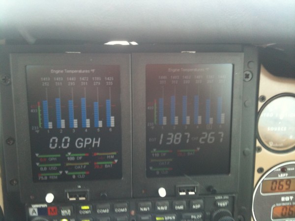

While getting ready to order the FS450M, I changed my plans. I ended up buying the JPI 751, an engine analyzer with two 4" screens. It's approved as primary for CHT and oil temp. I added the fuel flow option, and it also comes with TIT, OAT, Volts, and 12 EGT/12CHT probes. I will eventually add RPM/MAP, oil pressure, and fuel pressure to give me a full view of both engines.
Unforutnatly it's not approves as primary for all instruments, so I'll have to keep some of the stock gauges. When I do a whole new panel my plan is to replace the primary gauges with different ones that have remote sensors so I can get the wet lines out of the cockpit.
For the price it was about 1/3 the price of a complete primary certified display. It was almost the same price as the "skymaster" version of the Insight G4. They aren't shipping the G4 yet but they'll pre-sell it to you and give you two G3 head units now. I ended up going with the JPI because the screens were larger.
Here's a pic of it in a different plane, this is how I plan to mount it.

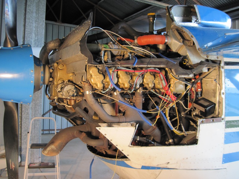

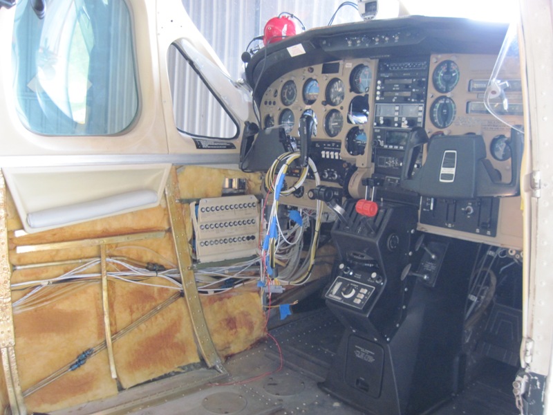

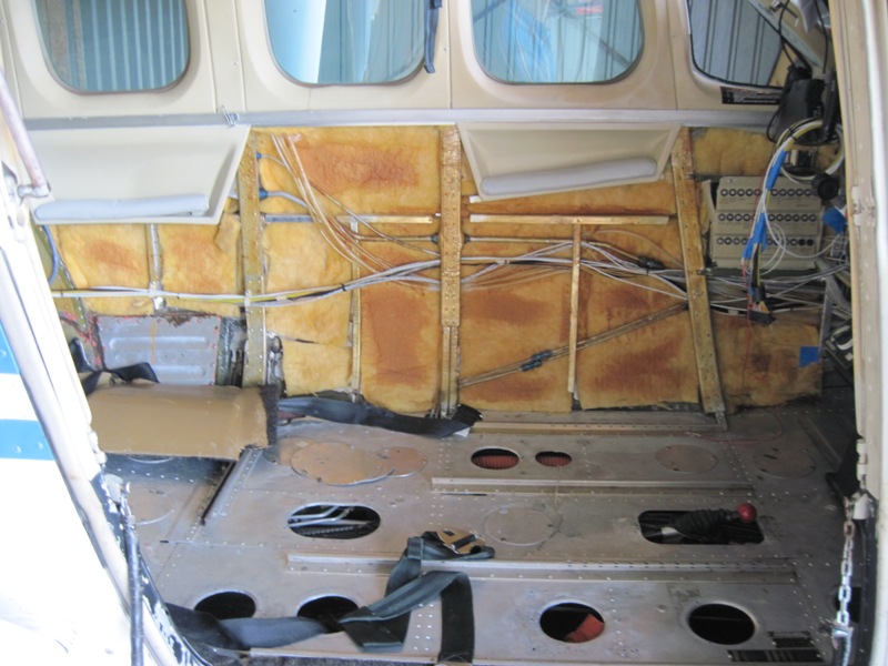

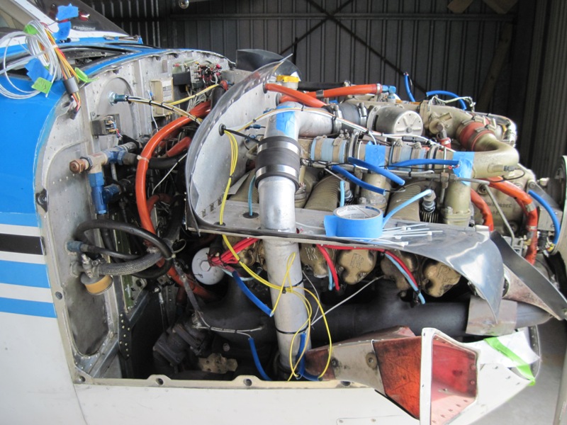

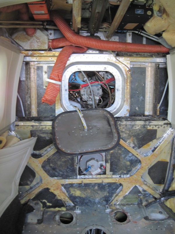

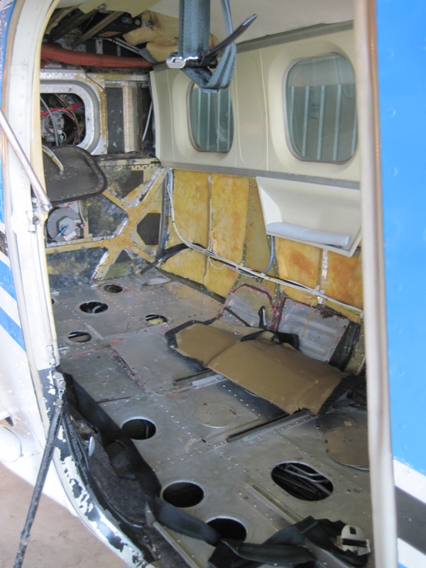

update: Monitor installation is mostly complete. We used the access panel in the back to route the wires thru. All of the sensors are wired in, all we have left is to wire in the gauge.
Along the way, I found out that you can actually wire the Shadin Digiflow to the engine monitor. Shadin says you can either use their fuel flow sensors or the Insight G3 sensors to drive both gauges. The big advantage to this is that I will be able to get rid of the wet fuel lines in the cockpit.
Brian

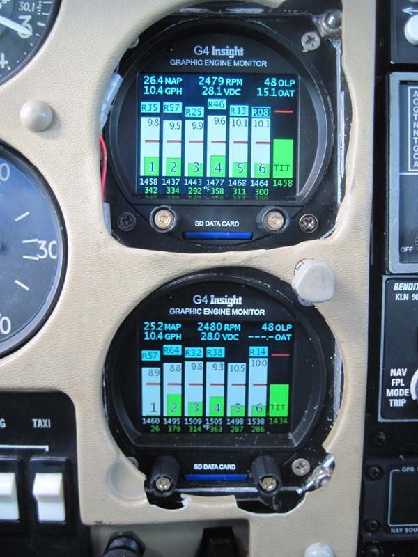

finally in. I ended up trading up to G4's. Now I to do more reading about LOP operation.
