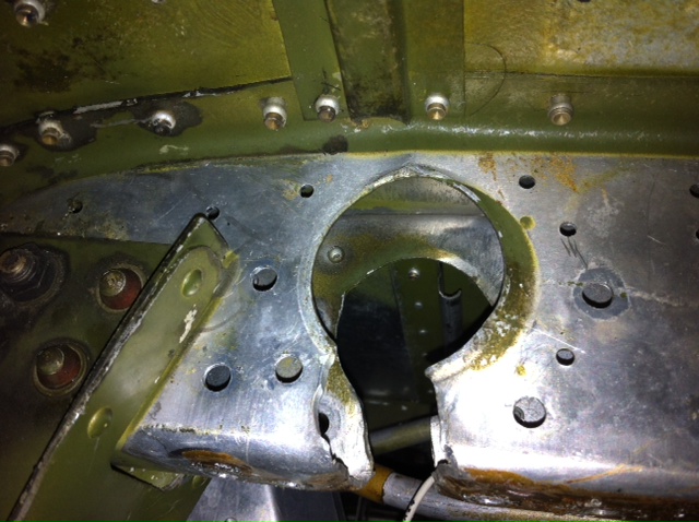

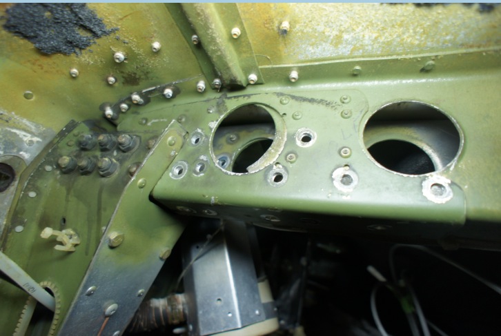

Attached are photos of the repair, one with bolts removed from doubler and one with doubler removed from hat section showing the damage to the spar, presumably cut out.
The log book states "repaired cabin spar per Cessna Engineering instruction".
There is no form 337 in the FAA records.
The work was signed out by Cruse Aviation Inc, no 2016, Houston 17, Texas on 7-22-75
Do these people still exist? Would they have any record other than that in the log book?

Unread 07-15-12, 12:26 AM
Posts: 511
What could have caused that damage?
Unread 07-15-12, 06:48 AM
hew's Avatar
hew hew is offline
Join Date: Aug 2011
Location: Australia
Posts: 32
No idea. Repaired in 1975, The damage would suggest the wingtip hit something but there is no obvious repair in the wingtip. It's been flying with the repair for 37 years. The repairer has become a residential address in Houston.
