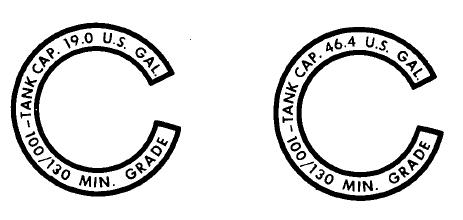

I don't have an E but I had a D, now have a G, and examined the parts manual for the E to prepare this reply to point 1: If the aircraft has two filler caps in each wing and the fuel selector valve for each engine has a stop for auxiliary tank, then yes, it has 128 gallons (see image for tank placards).

Name:	337E Fuel Tank Placards.jpg
