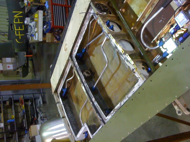

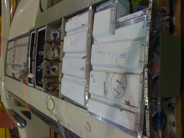

The tanks are composite, I assume glass and maybe a little carbon fiber. Each tank sits in the void section of the wing, these are the same spaces that the stock ling range tanks occupy so I think that is why there was no flight or loading restrictions.

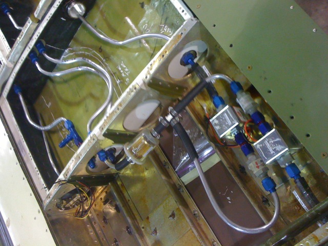

The tanks are configured with an inner and outer independent tank on each wing. They use transfer pumps to move fuel to the main tanks.

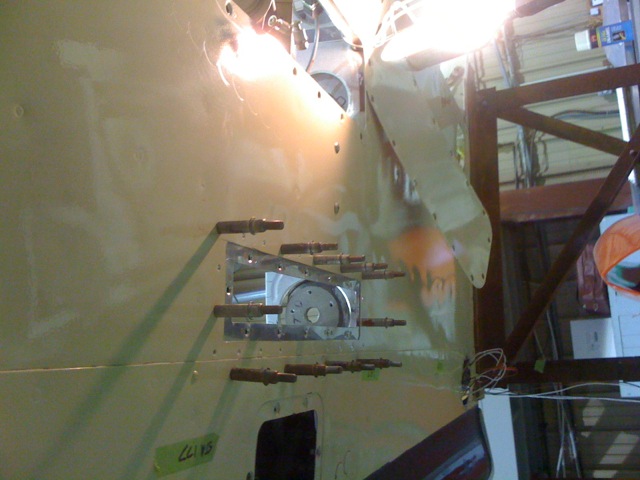

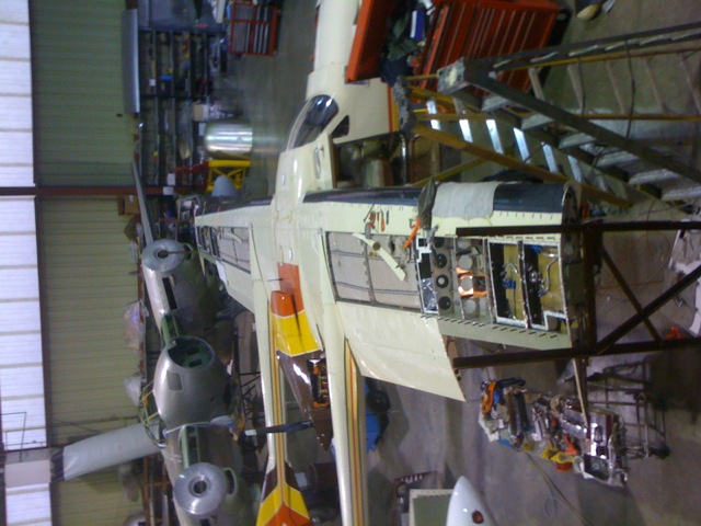

Hope this answers the questions. I will try to attach a few pictures for clarity.
