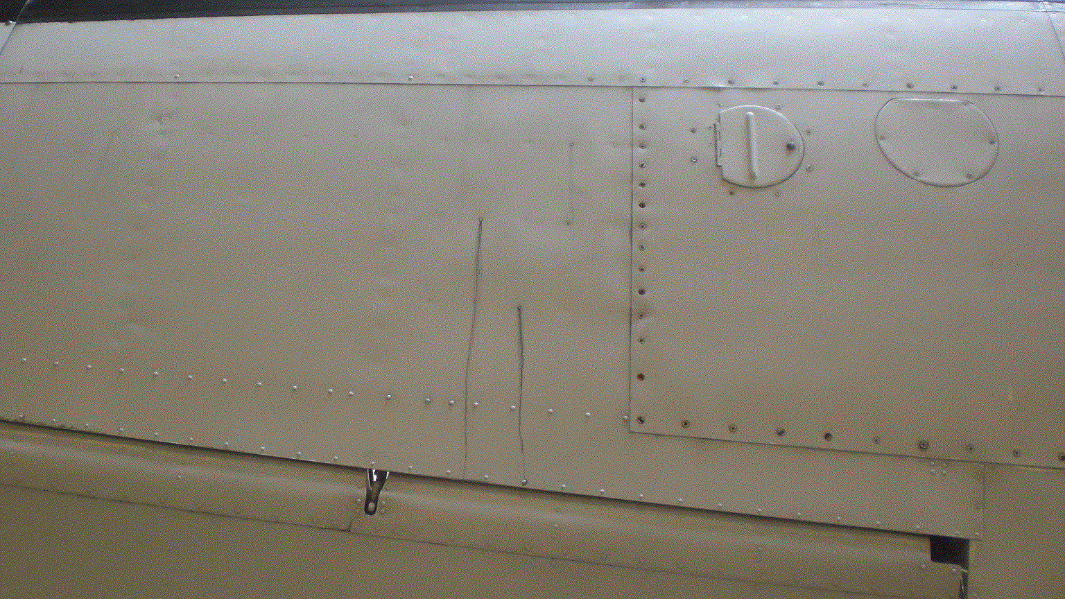

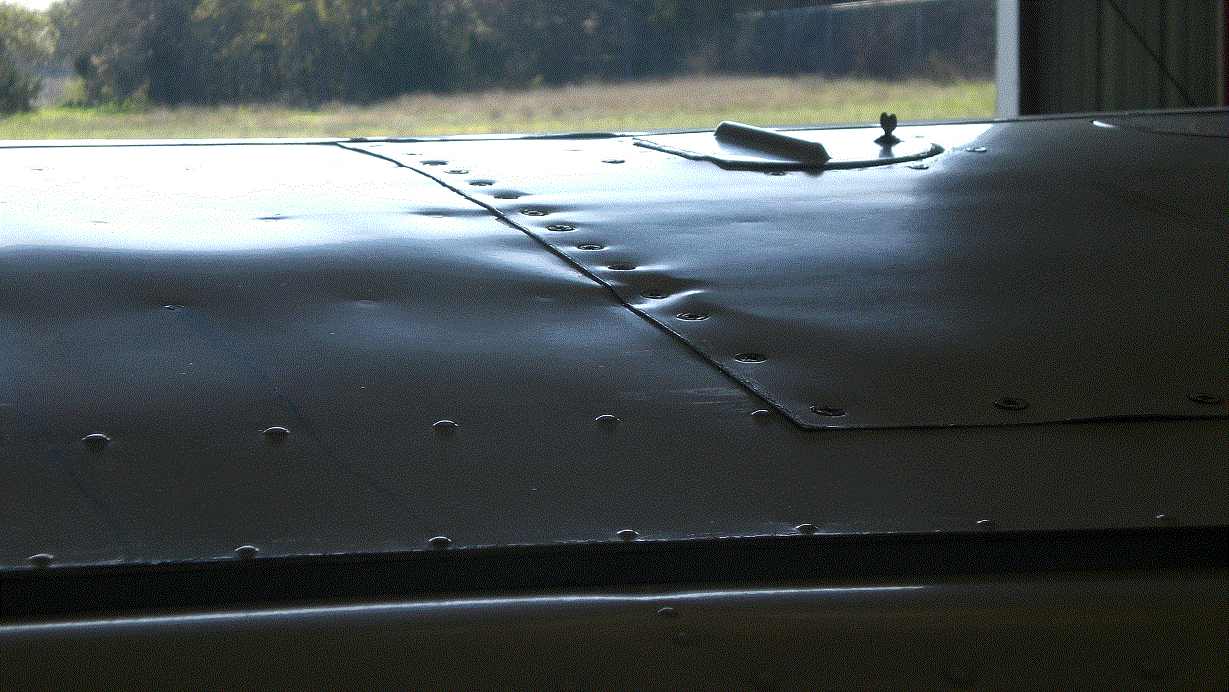

I found a few "smoking rivets" at WS-162 and some slightly deformed skin at WS-150.
I can shake the hell out of the whole plane when I do the "Cessna wing rock" and there is NO apparent flexing in the wing...and I mean I can really go to town rocking that sucker...but I am well aware that I am not putting anthing close to flight stresses on the assembly.

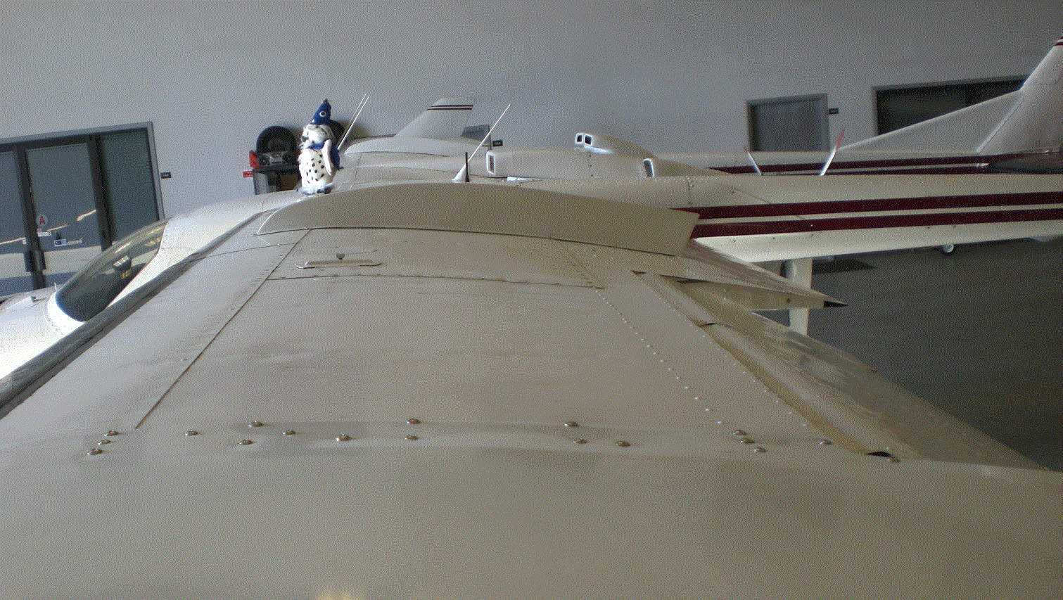

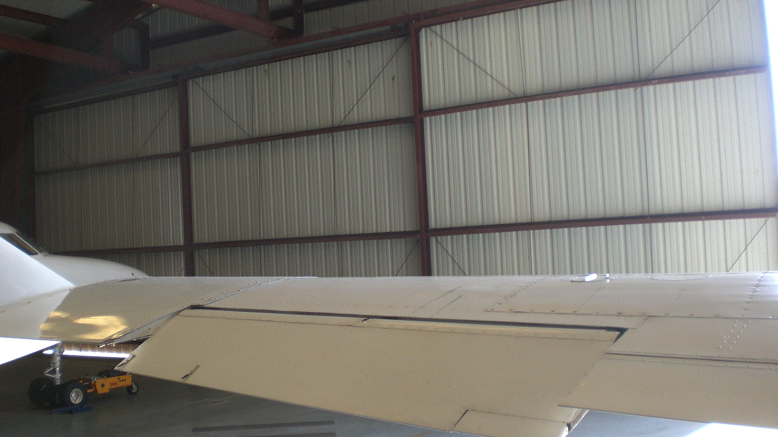

Here is what I found in my cursory look-see.
Left wing:
A few smoking rivets (barely visible in image 1406).
Warped Metal at/near WS-150. The warps are so shallow that I had to get creative with the lighing to make them show up on the photo.
The shop here cant get to it until mid week so I'm on pins and needles for now.
I cant wait to hear back if I have an unsafe wing or if I am good to fly (ALWAYS well within placarded limitations). Then I'll be able to start sleeping again.
If any of yall have any thoughts / opinions / or similar findings, please share them with me. The FAA is saying that this is apparently becoming a fairly common finding with those plane mounting BOTH the extended tips AND the winglets.

Hi Cole,
I don't think that you have to worry about the smoking rivets at all. Those are where the aileron bellcrank is, and those rivets are not sealed. They are fasteners to attach the bellcrank mounting flanges, and if the mechanic were to spray LPS 2 or WD-40 up in there to lubricate the bellcrank bearings, the excess would naturally bleed out thru the unsealed rivets holes. The same would also be true if the wing was recently sprayed with Corrosion X or similiar treatment.

The wrinkle does look scary. I'd love to hear what the mechanic has to say. I wonder if Cessna will make new wings for out planes? If so, will that reset the spare inspection clock?

Looks kind of ugly
