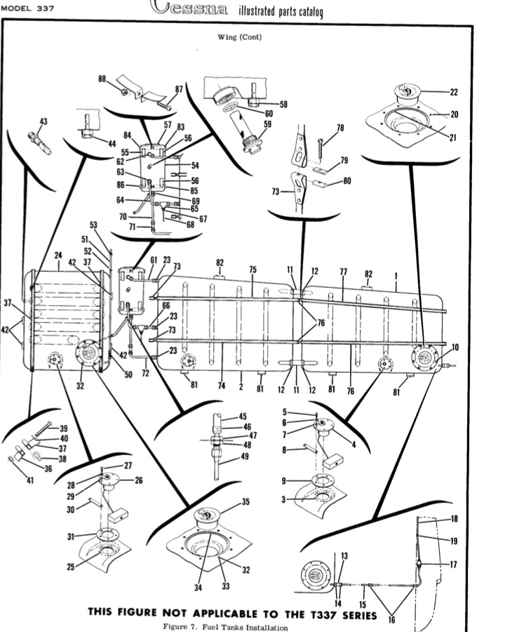

I think you want an S350, which is a standard/stock aerospace part (see figure below).

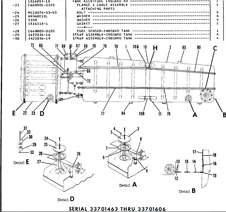

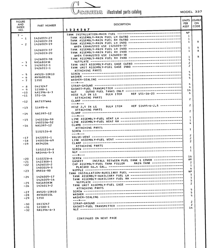

Guess it depends on the model. Here is from my PC
Part #31

ID:	1001   Click image for larger version

Yes, Ed, it does depend on the model. Since I know yours is a '73, the picture in my message is from the parts manual for a '73.
