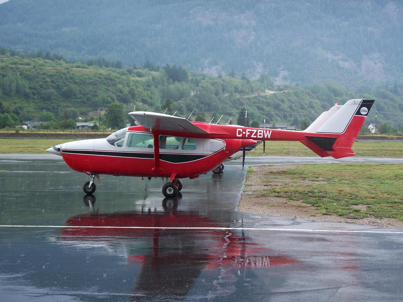

Here is a picture. The paint isn't the greatest but it's ok for now.
