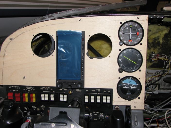

I took the plunge in a big way. I got GKEY ferried over to Victoria Avionics and we started talking new units over the phone. My new centre stack will now be (from top to bottom): Garmin 437 audio panel, Garmin 530W, SL30 NavCom, S-Tec 55 (currently in the stack), DME (currently in stack), Garmin GTX 330 S transponder, ADF (currently in stack). The S-Tec 55 has been sent back to the factory to see what went wrong and if it can be repaired, otherwise we buy a 55x.

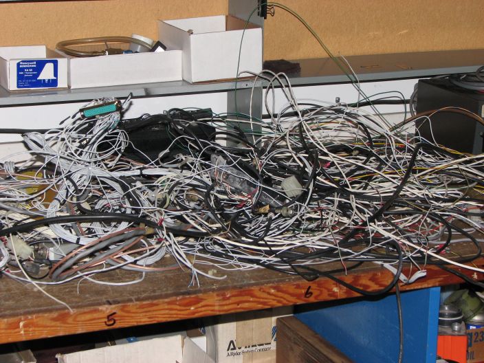

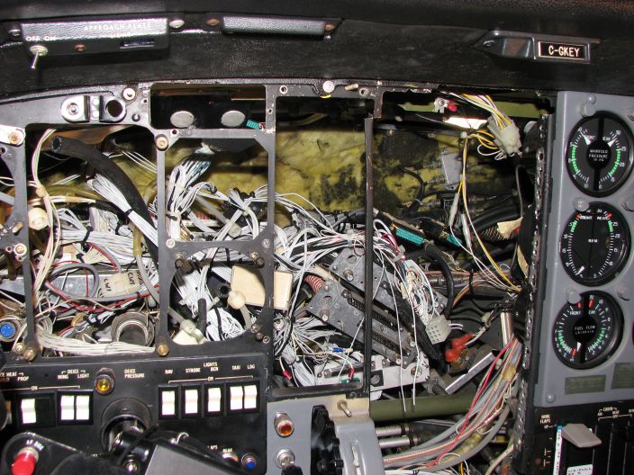

I am also removing the left and right panel and have new ones cut. The left one is planned and configured to take the Aspen PFD and MFD's. I am throwing out almost all of the current steam gauges and will install the 2" Mid-Continent back-up trio gauges. The right panel will house the new Xerion AuRACLE 2120 engine monitor, and because of all the new electronics I'll have to have a second breaker box. This will be made electrolumiscent and dimmable, and will house all the avionics related breakers.
So far I am over $50K just on hardware alone, but I realize that. To me it is a favor returned to the best girlfriend I've ever had - beloved my 337G.
