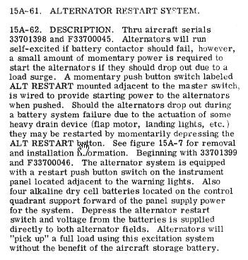

Unread 01-29-08, 11:34 PM
Location of batteries
From Page 15A-23 of the service manual - Does this help?
