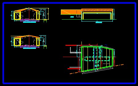

Ahhh... Me too... here is my drawings of my hangar... but, I have a 45 ft door... bifold...
Unread 07-06-02, 02:33 PM
Should I have been able to download that drawing in a form that is readable? I can just barely make out what appear to be dimension lines.
