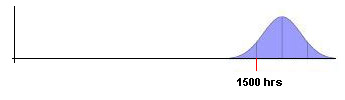

I think your course is reasonable. TBO is very meaningful for carriers (like Part 135) who have to abide by them. For Part 91, there is significant merit in using "on condition" criteria similar to that used by major airlines in the maintenance of jet engines. Basically, I monitor the engine as you do -- oil consumption, oil analysis and, for older engines, perhaps double the frequency of compression checks to twice a year -- and fly it as long as all parameters look good.
I do this, in part, because it's a twin. If I had a single engine, I might do things differently, especially if I do a lot of night, IFR or over-water flying.
I don't know exactly what the failure distribution of IO-360 is, but for properly maintained engines and after discarding "infant mortality" events*, it might look like the figure below. 1500 hours marks the point at which failures start becoming frequent, but most engines last for much longer, and mine could be one of those, so I keep them running until there are signs of problems.
________________
* Defective parts or improper assembly will cause some engines to fail very early -- perhaps just hours after overhaul. These failures are due to "infant mortality" and are not considered above. Incidentally, I'd much rather be flying a half-time engine with no sign of problems than one with 20 hours out of overhaul.

I'm curious where you've obtained your 1500 hour statistical criteria, that failure rates start becoming frequent within and beyond this time frame.
I look at it this way: If the engine has performed well within the last hour, it's most likely to perform in the same mode during the next hour. Trend monitoring of the engines, how they sound, what they look like under the cowl at Cessna maintenance recommended checks (like the exhaust system), as well as the look of the oil and burn rate would seem to be better indicators of what to anticipate as far as overhauling an engine. In fact, in may be a situation that the power producing end may be the only items that need to be taken care of, i.e., the cylinder assemblies.
With the new turmoil on the VAR cranks, those that have a good running engine should think twice about splitting cases.
I see no statistical probabilities or mortality rates for an engine that is 10 years old versus one that is 20 years old or older.
Nice graph, but I don't think it's very realistic.

I think you misread my message. My main point is, and I quote, that you should "fly it as long as all parameters look good". Let Part 135 operators worry about the 1500 hours. I then went on to say that I don't know what the failure distribution looks like. The sole purpose of the graph was to show that more frequent failures may start appearing at 1500 hours, but that for most engines there are still lots of hours left -- absent, of course, poor maintenence and infant mortality (see Kim Geyer's examples in his message on the thread entitled "IO360 - Factory new vs Factory rebuilt" and Chachi's example above).
In short, I agree with you and Chachi: keep a good engine running.
