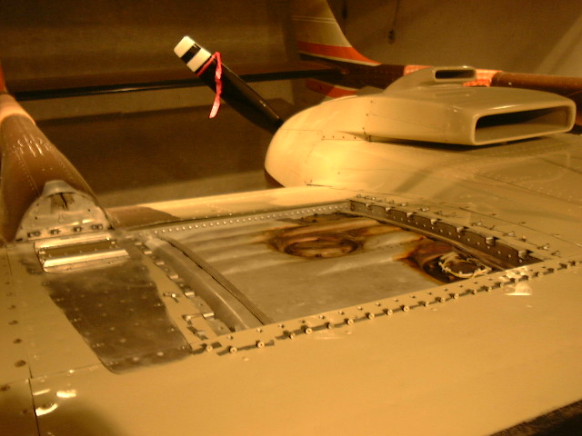

More tank pictures....
This is another shot of the right inboard tank with the top cover removed... you can see where the fuel had been leaking from the middle and aft inspection ports.
At the edge of the tank, nearest the cabin side, you can see the slots in the top of the wing structure where the 'HAT' sections of the top tank cover fit ... and where the longer screws are used. Yes, the tank cover is part of the wing... structurally speaking.

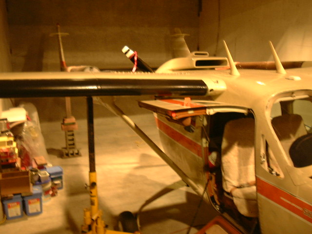

Wing jacks in place...
Sorry for the slightly 'fuzzed' quality of the pix, but this was my first time using the digital gadgetry.
Here we see the boom support... kinda crude looking, but it did the trick... with a nice big cushy soft rag on top of the 4X4. The jacks were also placed under both wings. The Service Manual gives you a good explanation why this is necessary -- before trying to take out or reinstall the ga-zillion screws on the tank cover.
And, yes... you DO have to remove the lead-fairing boom cover BEFORE you can remove the tank cover... at least on the 1977 model.

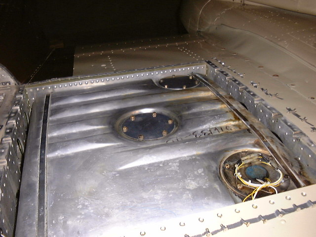

Close-up after cleaning stains...
Here's a close-up of the tank after cleaning the fuel stains off. And by the way, just using a little avgas on a rag does the trick well. Here you can also see the wiring for the Penny Cap sensor.

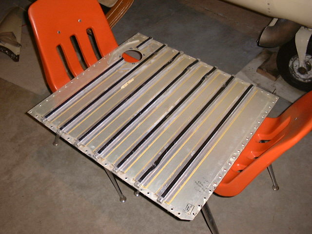

Top tank cover...
Here's the underside of the inboard tank cover... notice the "HAT" sections with the anti-chaf tape... these "HAT" sections provide carry-thru strength of the wing structure across the top of the tank.
We'll post a few more pictures later on showing the inside of the tank and the Penny Cap fuel sensor.
