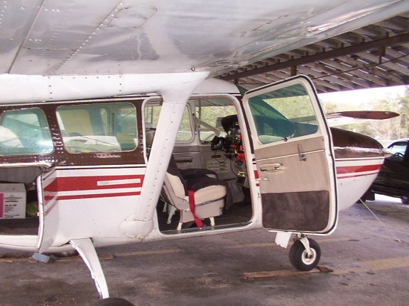

P.S. Check out my new interior

SWEET Interior!!!! Do it yourself? Let's see more!

Hi Richard, I have done the interior my self, every stich of it. All the materials used have 8110's. If any body need any advise, just e:mail me at :skymaster44@hotmail.com
