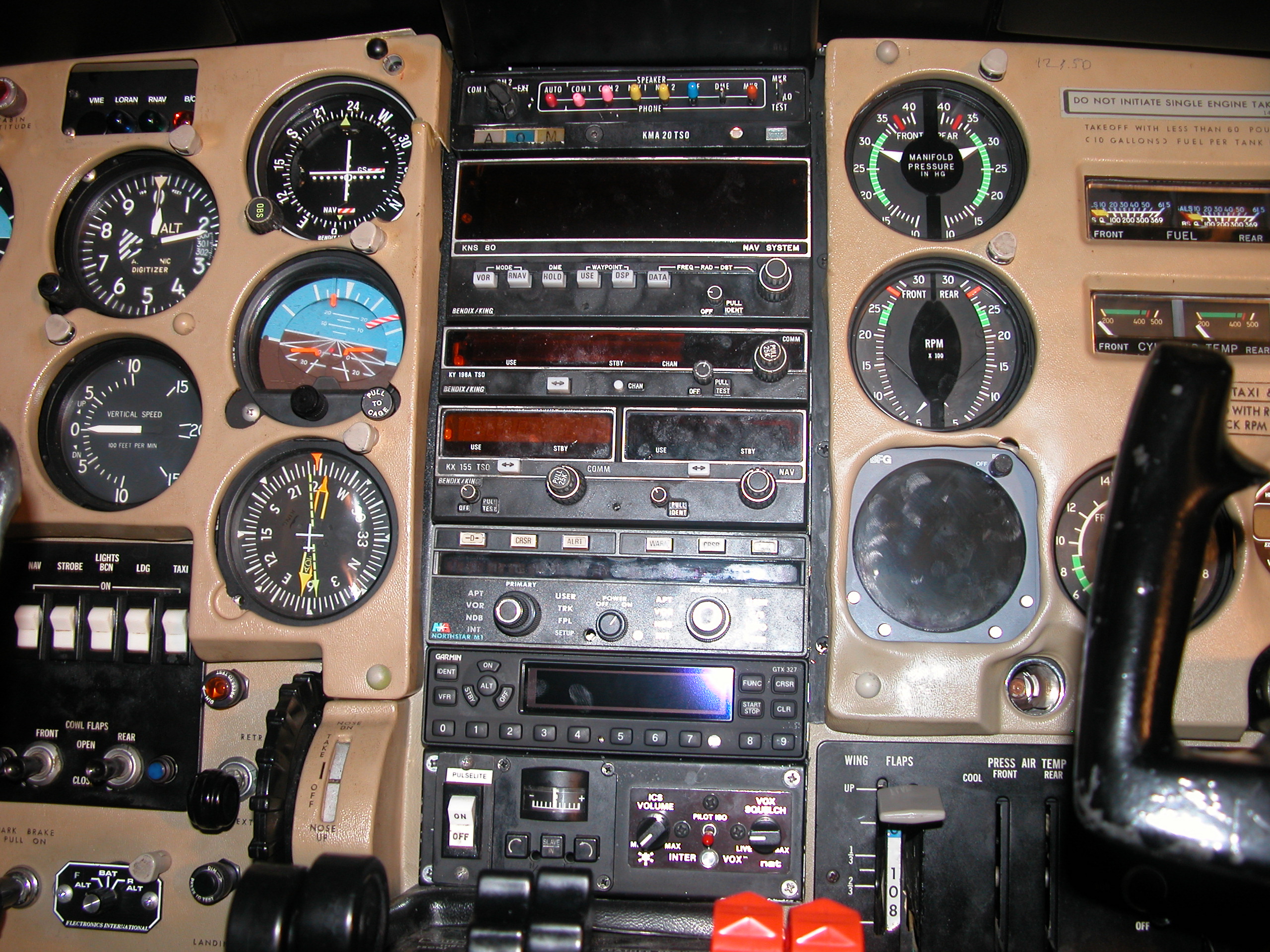

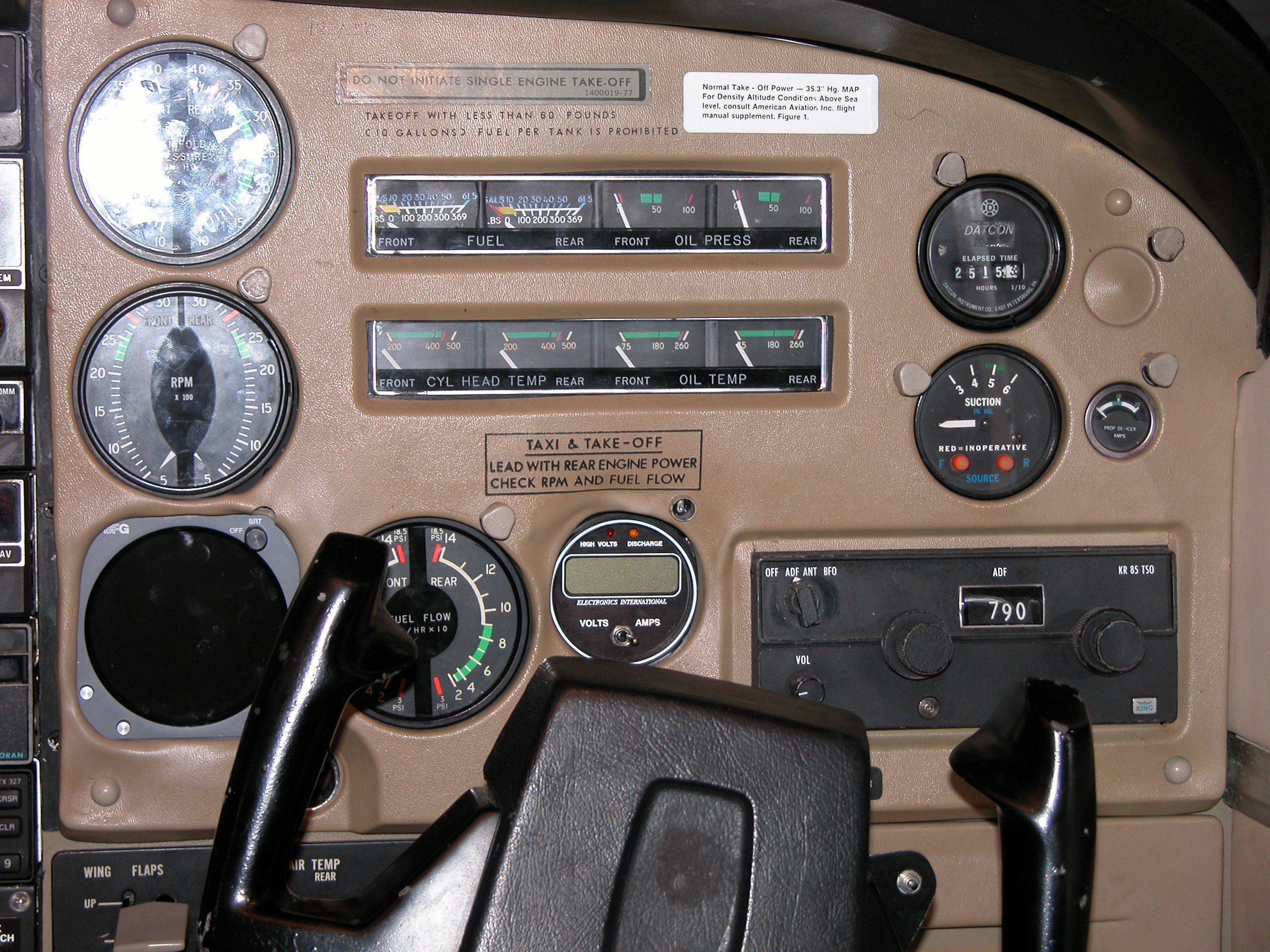

The meter went in the instrument panel, as did the switch (well, you asked ;-). The actual indicator went on the co-pilot instrument panel in the hole where the Cessna EGT used to be, to the right of the fuel flow indicator and just above the copilot control wheel. The switch went below the cowl flap switches. I will attach a picture in the next message (not this one), you can see the switch on the lower left, and a small slice of the voltammeter on the far right. I will attach another picture in the next message after that showing the volt ammeter better.
The shunts went on the left (pilot's) side of the firewall in the engine compartment. I can't remember, but they were fairly high up, fairly accessible from above.

Center instrument panel.

right panel.
Unread 01-30-04, 01:57 PM
One more point, you can see in the second picture that the plastic around the gauge has been reshaped with a heat gun. This was done to make the discharge warning light on the guage visible from the pilot's seat. Without the reshape, the plastic covered the pilot's sight line to the warning light.
