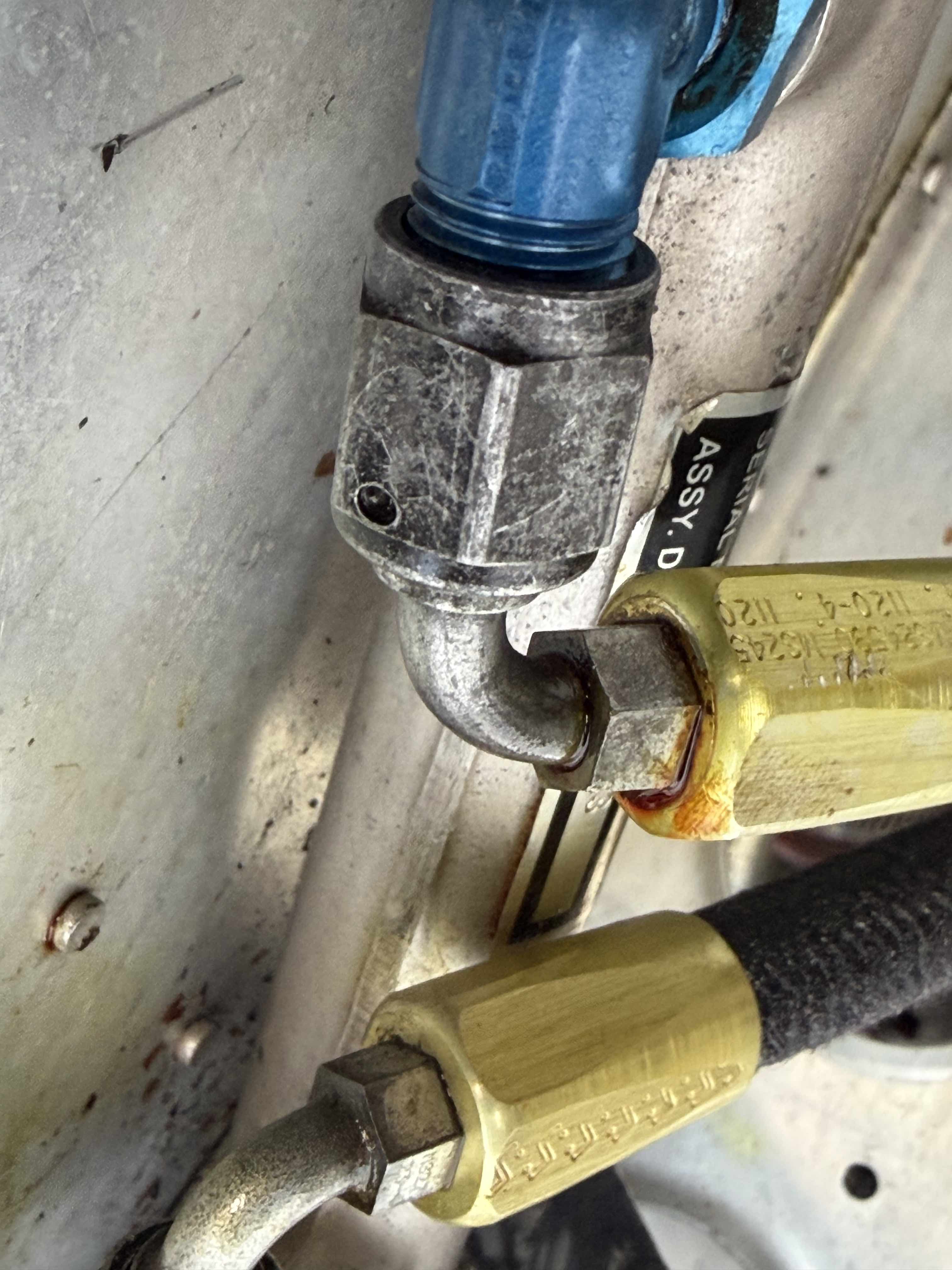

Hi, looking for the fitting that go into the nose gear actuator. Parts manual is a little vague. I have attached a photo here. I can source the big gold piece (part number is right on it) but the other end that makes the 90 degree bend does not appear to have a part number.

Gord,
In the US, that’s “standard hardware” and some of us source it from pretty much anywhere.
Could call Precision Hose Technology in Tulsa (I had them make all new hydraulic hoses for my bird) they’ll know exactly what that fitting number is.
Www.aircrafthose.com
Alternatively, could call my favorite supplier, Genuine Aircraft hardware in Billings, MT and ask them. They have a great free illustrated catalog and know their stuff.
Www.gen-aircraft-hardware.com

Is this what you are looking for?
https://www.aircraftspruce.com/catal...s/AN822-4D.php
