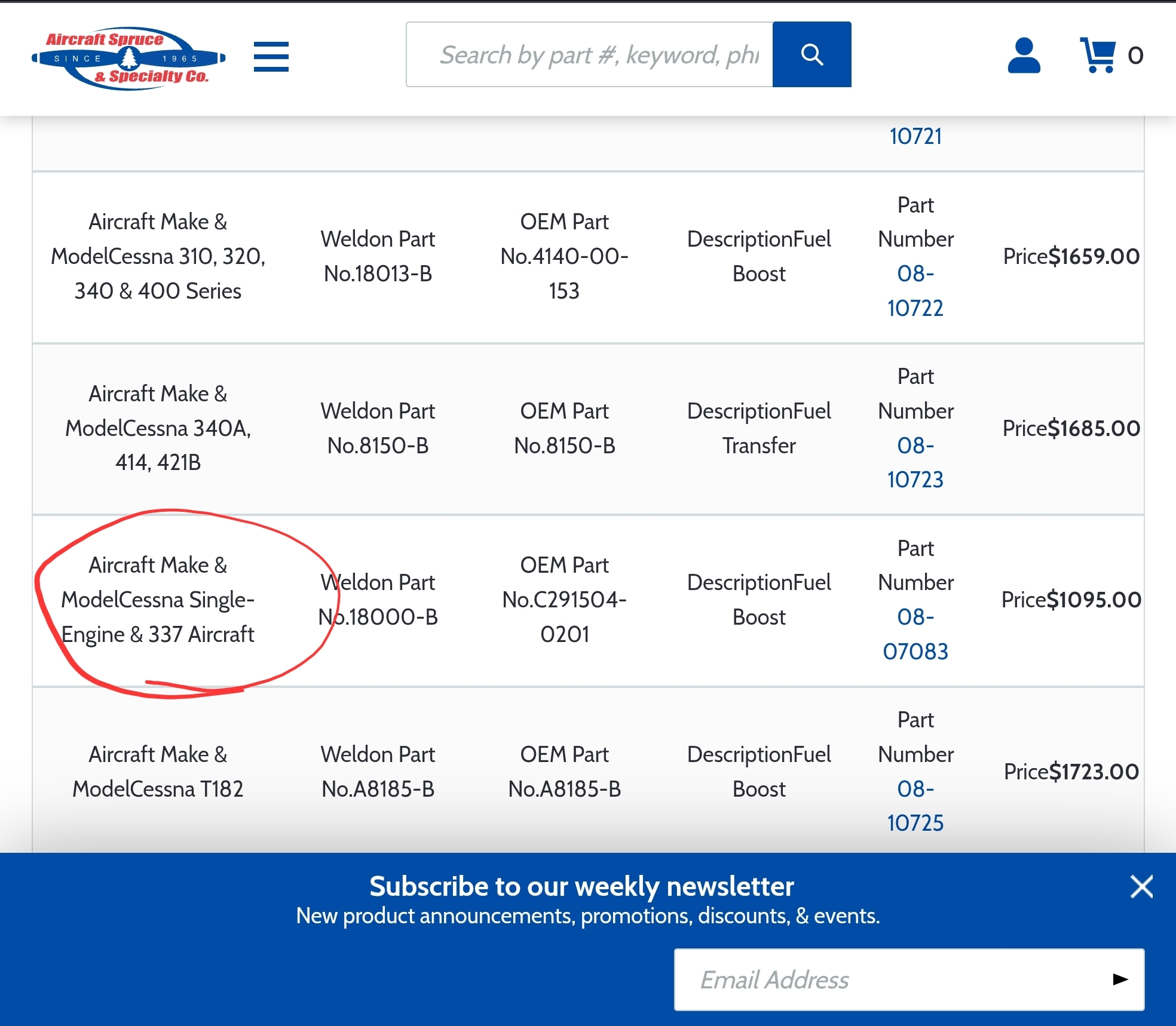

Unread Yesterday, 11:54 PM
YankeeClipper's Avatar
Join Date: Apr 2013
Location: CT
Posts: 285
Aircraft Spruce sayeth:
