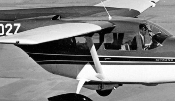

When Cessna introduced the 336 in 1964 it didn't have the upper scoop and relied on a fan driven by the engine to pull heat from the rear cowl. There was one large cowl flap at the top center of the cowling to allow air to be introduced to the cowling mechanically. It worked ok but there were some rear heat issues that has plagued the design ever since. You can always identify a pilot that has never flown a 337 Skymaster because they think and ask about the rear heat problem. There really isn't a rear heating problem on the 337 design with the upper scoop and mechanical cowl flaps on each side of the cowl. When the turbo version was produced the cowl flap size was increased about 25% and that carried on to the pressurized version beginning in 1973 with the G model change. All 500 or so military built 337's had these larger cowl doors even though they were all normal aspirated.

One other related question: there’s a scoop (definitely different from the 337 design) visible in this old 336 pic I found online, so was this perhaps an early pre-production prototype? The original photo before cropping showed 3 identical 336’s in formation.
