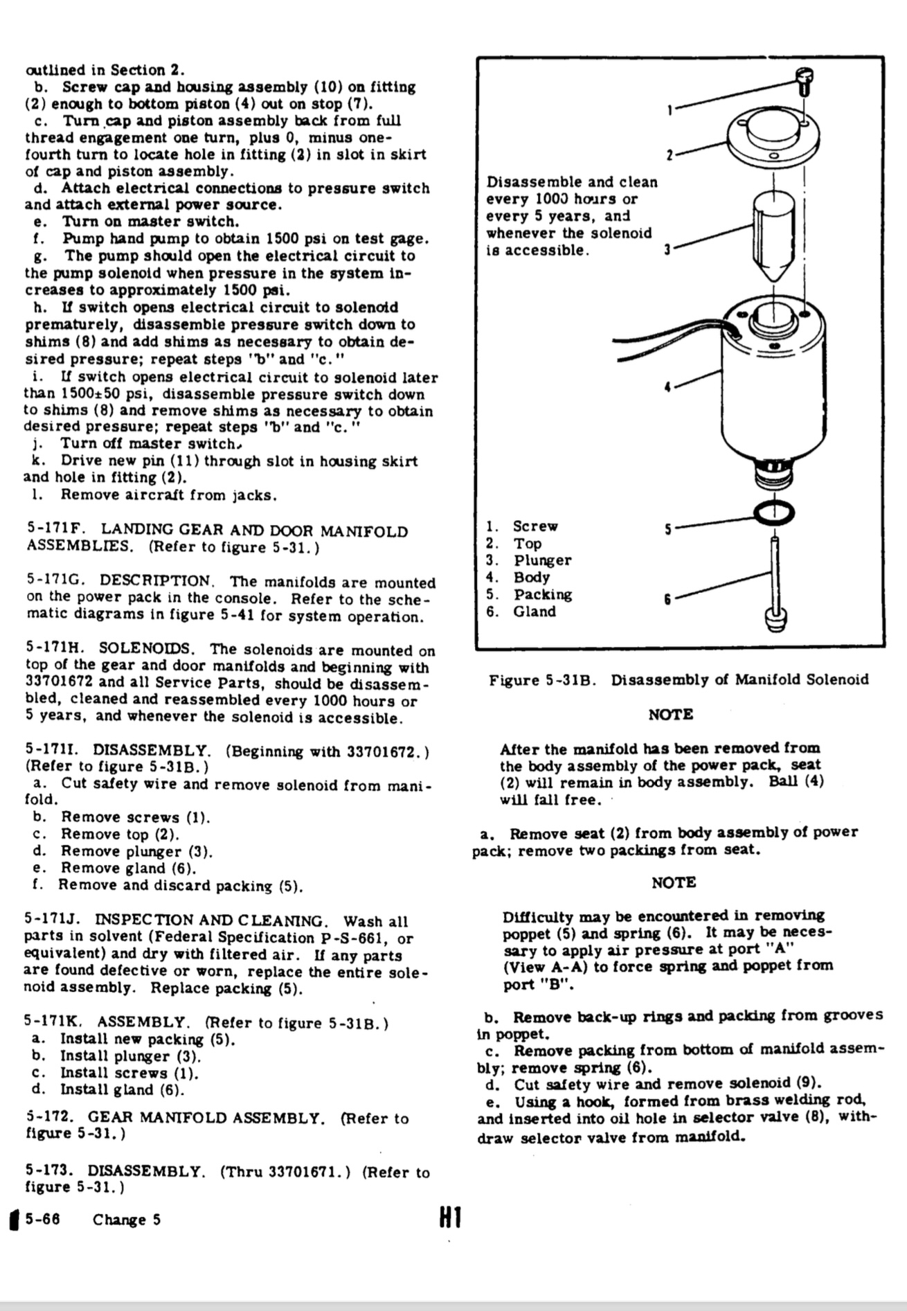

>>>sticking solenoid <<<
When was the last time both of them, (door and gear) were removed, cleaned, and the oring replaced?
Easy cheap stuff first.

Thanks Randy!
I’ll do both solenoids first, as logbooks have no record of the solenoids, or the power pack, or the actuating cylinders ever being done. It’s possible the aircraft has vintage 1977 hydraulic fluid in the lines!
Update: removed, clean and replaced packing (MS28775-014) on both solenoids. Jacked aircraft and ran gear 5 times in a row with no issues.
Instructions attached.
Last edited by Learjetter : 08-10-24 at 11:36 AM. Reason: Update added, packing part number added

Any part numbers for the packing and the instructions would be nice.
Thanks, Joe
Unread 08-10-24, 01:33 PM
Join Date: Oct 2022
Location: AZ
Posts: 66
337 parts manual, figure 125, item 11:
MS28775-014
One on each solenoid is required.
