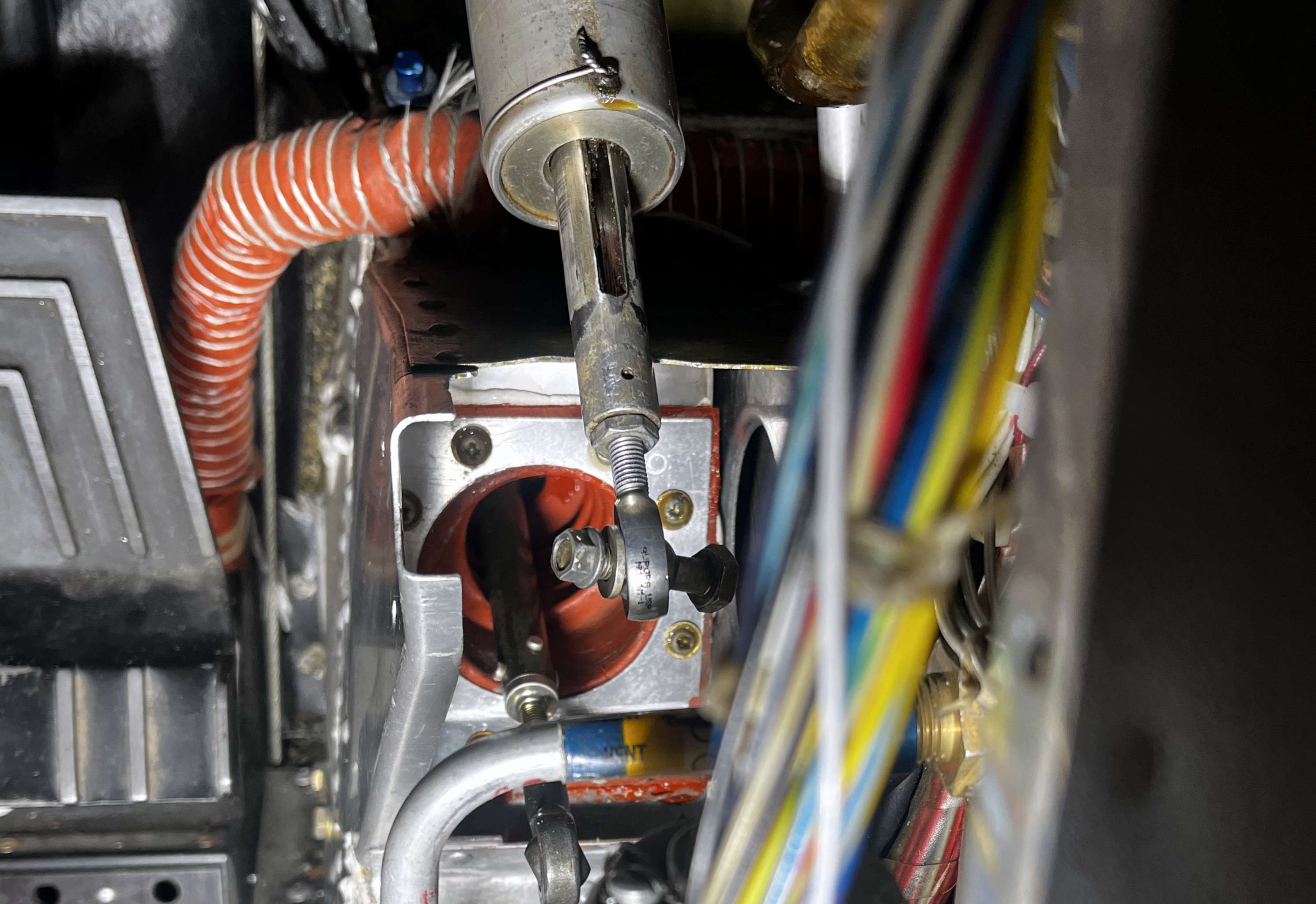

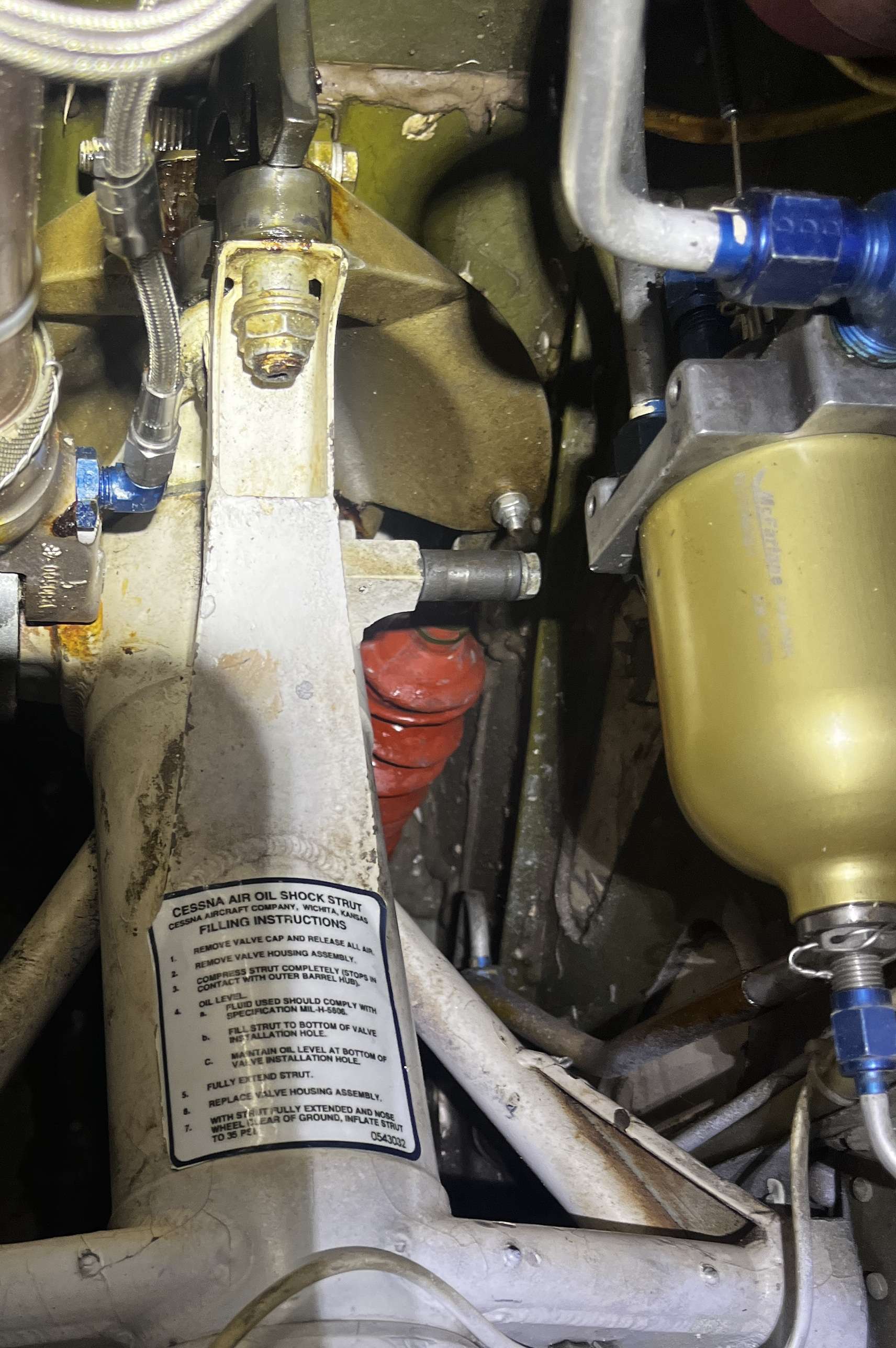

You said you had heard hissing sound under the panel, the only two places I know that are potential leaks are the 2 access cover in front of the windshields and the boot around the nose wheel steering rod, it holds pressure. I had just installed Cessna Service Kit SK337-45B to strengthen the nose wheel steering actuator pivot and found some minor holes in my boot.
I think he is referring to the door seal system
