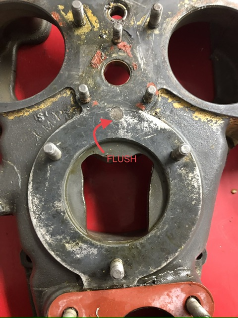

Removed rear accessory case do to oil coming from the driven oil pump shaft that is press fit into the case, mine is not flush with goop on it. There is two gaskets one for the alternator and one for the tach cover. The original 360’s had one gasket for both, which is what I am going to install. This shaft is supposed to be flush with the rear of the case installed with loctite 271 and primer, it does come in over sizes.

Here are a few pics. The shaft for the driven gear is supposed to be press fit in the case with 271 loctite. The other pics are the new oil pump drive gear, oil pump gear, and new screen called out in SB96-4. I am amazed on how small the original key is for the oil pump gear.
