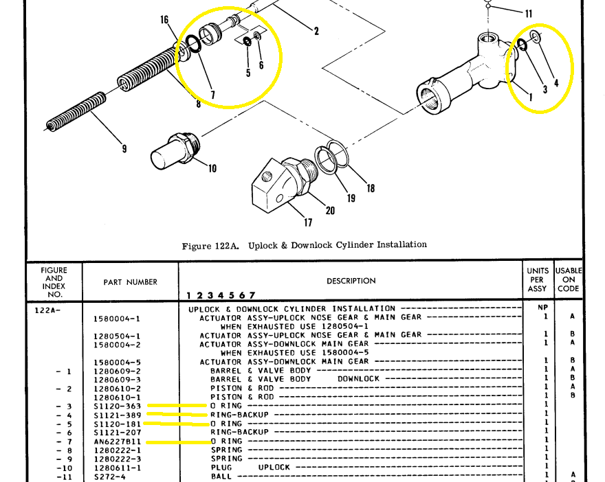

Can't find the break-out for the up-lock actuator in the IPC - says see Fig 46... in Fig 46 .
Need cross ref's for MS28774 teflon packings .
Need alternative PNs for : S1120-363, S1120-181, S1121-389, S1121-207
Thanks!

With the exception of S1121-207, Airpower has all the Cessna parts numbers in stock for $15 or less each. The S1121-207 must be made of Kriptonite, they have it in stock, but it is $129. So other than that part, the pricing seems really reasonable. Many times they list alternate MS or AN part numbers for Cessna numbers, but not for that part........

https://www.airpowerinc.com/s1121-207
$12.39
56 in stock, available to ship now.

https://www.cessnaparts.com/?s=S1121...t_type=product
S1121-389
Standard Packaging of 5 items
Info --
RING, BACK UP TEFLON
In Stock $117.88 $103.73 --
S1121-389 quantity
Yep 5 for $103.73
$21.oo each, give or take...

Unable to find a S1121-329
Are you sure that is a good number??

AN6227B series is the cross ref for the MS28775 orings.
Aircraft spruce has them.. the whole series...

https://military-fasteners.com/ms-se...rings/ms28774/

Thanks a Randy, you're far more patient than I with dealing with part searchs !
Okay, so the door actuators use standard MS28774 & MS28775, that's easy.
The Cessna PNs are only found on the up-lock / down-lock actuators :
