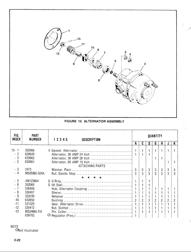

Hello ALL.
Need some advice on removing my front alternator. Having a problem with the front alternator not charging, did the diagnostics. I read in the MX manual and it does say to remove it from the left side of the aircraft. But has anyone remove one before. NEED HELP!!
Thanks in advance
