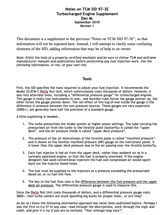

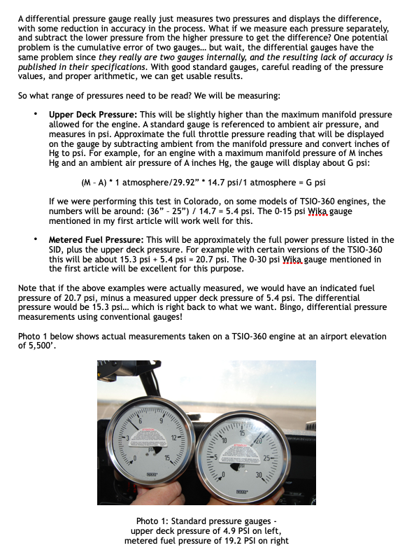

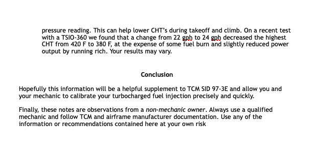

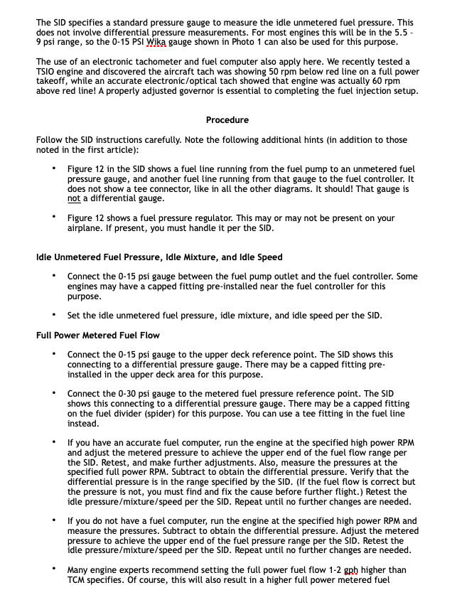

Joes Joes is offline
Join Date: Dec 2021
Location: Abingdon, VA
Posts: 95
TSIO 360 Metered Fuel Pressure Settings simplified
Thanks to Dan M. for the breakdown into the metered pressure analysis and for taking a look at an alternative approach to setting these pressures. Joes
ps: the articles pages are not in order.
