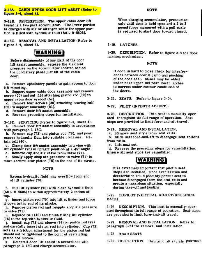

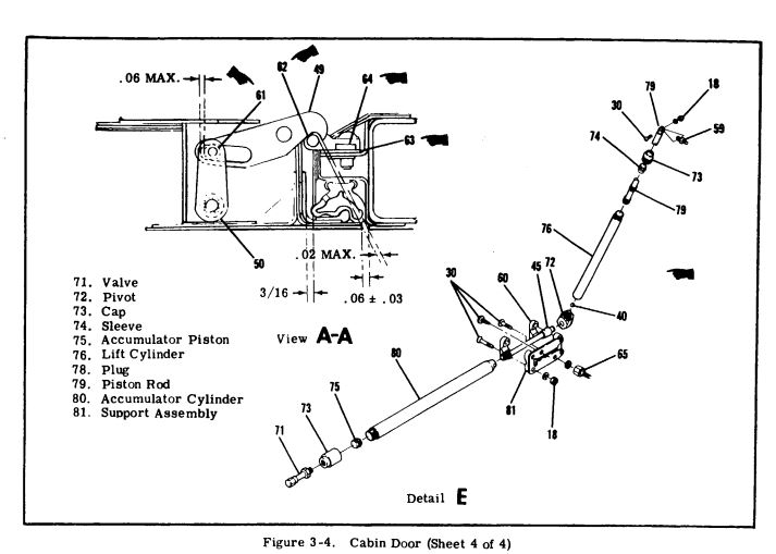

Good info LearJetter! The instructions are pretty similar for the 1978-1980 models. Below you will find them, plus another diagram. Interesting that it calls for shop air, not nitrogen, to refill the accumulator.

If your door just seems to lag a bit, where you do have some lift but have to use the friction lock to hold it at the top, would a small burst of shop air or nitrogen be appropriate to give it that last little bit of push?
Surprisingly, the manual gives no recommended pressure, just say basically to fill with shop air until the door opens correctly.

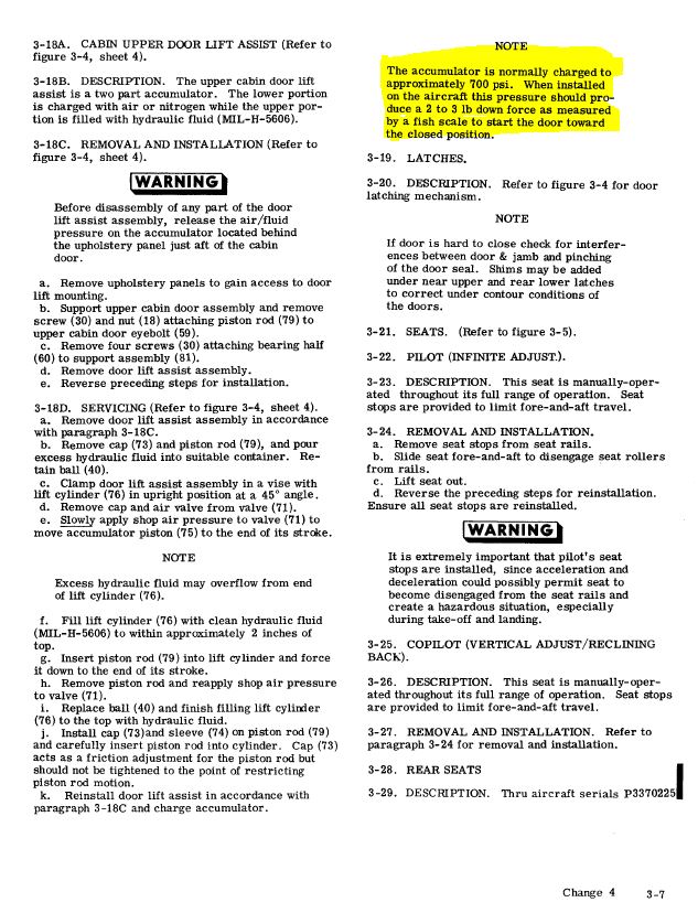

My service manual says to charge the cylinder 700 psi. But yes, it would be nice to see pictures. Must of been a later update.

When I resealed ours I’m thinking I would give it about 525 psi to get the door to raise on its own. But that was my old gauges the only interior I had to remove was the trim around the window behind the door and the aft door trim.

No, its just my reading comprehension skills. I scanned it too fast and saw where they use shop air at the beginning of the procedure. I assumed that was to recharge the accumulator, but if you read further, you see that its not.
