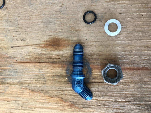

Front turbo wastegate actuator seep
Tired of seeping from the oil inlet actuator, gonna try a nut that has a Teflon backup ring for the oring. Will see if it works better

Posts: 141
Ended up being the small oring on the treaded post with the lock washer and nut. Unfortunately I did not replace it when I replaced the piston seal and expander. Not too big of a job though, easy to disconnect the actuator from the waste gate.
