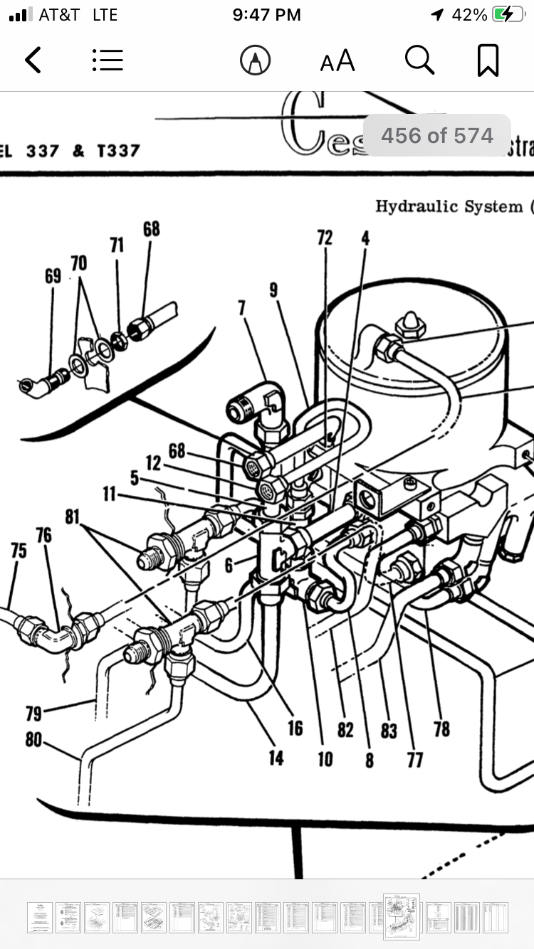

Unread 11-05-22, 10:54 PM
Looks like the fill tube goes to the bottom of the reservoir. If so, missing that nut leaves tube open to a high pressure area from ram air. Can pressurize reservoir and possibly even bubbles the fluid introducing air or even foaming.
See attached link
Tube #68
File Type: png DBF3836C-322C-4406-BC8D-A9CEF82BA1BE.png (406.6 KB, 2204 views)
