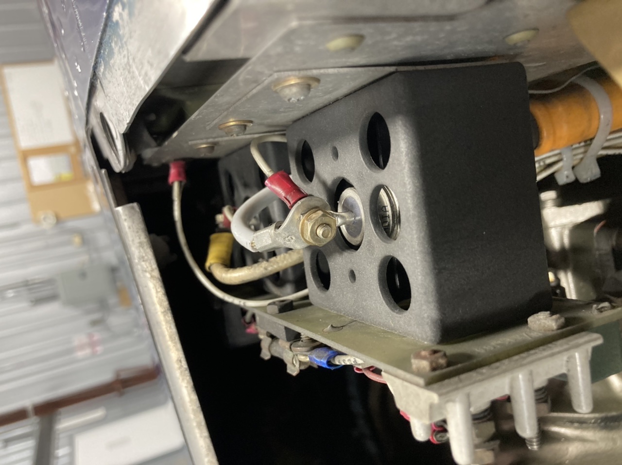

where now too look. I had the diode board changed some years ago and physically it looks ok
