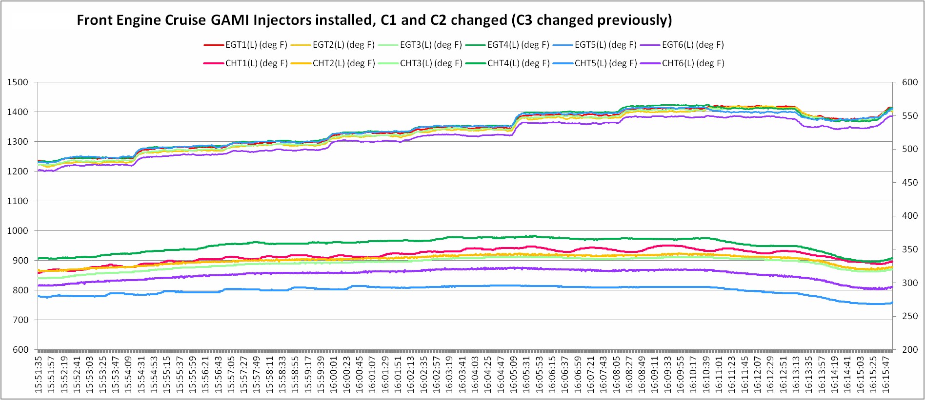

I installed them on the front engine a few years ago and am very pleased with the results; engine feels like it's running smoother, CHTs and fuel flows are equal. Note that it took three attempts to get the correct sized injectors.
