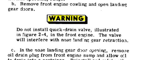

I'm sure the STC'ed ones are fine, but the Service Manual has a big warning saying not to use a quick drain as it could interfere with the nose gear transit. It looks like a "short" quick drain will work, but not a normal one. YMMV.
Here is the correct one for our Skymasters for $115 from Wag-Aero: https://www.wagaero.com/low-profile-...es-p-nf65.html
I've attached the section from the manual.

My recommendation for the STC'ed Bogert quick drain valve does not interfere with the nose gear. I am an experienced mechanic. I have installed one on my C337A, swung the gear and verified the clearance. It is not an "external" quick drain, you have to have a tool that pushes up "internally".
Thought I would clarify - I don't make recommendations on this site that I have not researched or validated.
