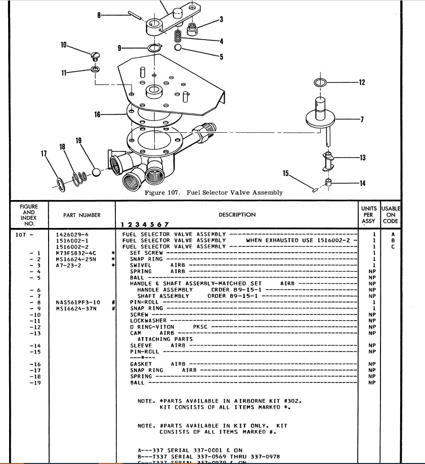

Here is the selector diagram for the older skymasters, not sure which one you have.
For Skymaster337B what part numbers did you use when ordering the ball and spring? The attached diagram does not have any parts numbers.
Thanks!
