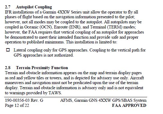

The last update of 4XXW SFMS, 190-00356-03 Rev. G, indicates that there are no autopilots authorized for LPV approaches (attached image). Not sure you could use the info posted for the 5XX SFMS if you didn't have one on board.
That said, Sandel had a software update that would allow my 3308 to do it. So, I purchased it, it wasn't cheap, and I had the avionics shop install it and do some hard-wire changes that it required. The update also provided the autopilot integration to fly it.

I always thought those Garmin AFMS entries were "checkboxes" and the installer goes through the generic AFMS and tailors it to your installation be checking the various limitation boxes. No checkmark in the box means the limitation didn't apply to your installation. I'll read up more on it.
That would make sense, jetter. I'm looking at a blank copy of the PDF on my computer. I'll be flying tomorrow, so I will look in the POH where the airplane's copy is.
